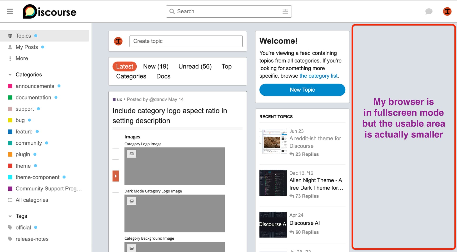

do you mean to the right of the image? I believe you’ll have to increase the site setting max image width from admin/site_settings — though note that this will only change new uploads, if you wanted to change the old ones the posts would have to be rebaked (Rebake all posts matching a pattern).
if you mean the post width itself, that’s just the theme… I might try to add some content there in the future

I seem to be having a similar issue… but only on the main screen. Here is a screenshot from right here on meta…
If I decrease the screen size a little bit… then everything jumps wider.

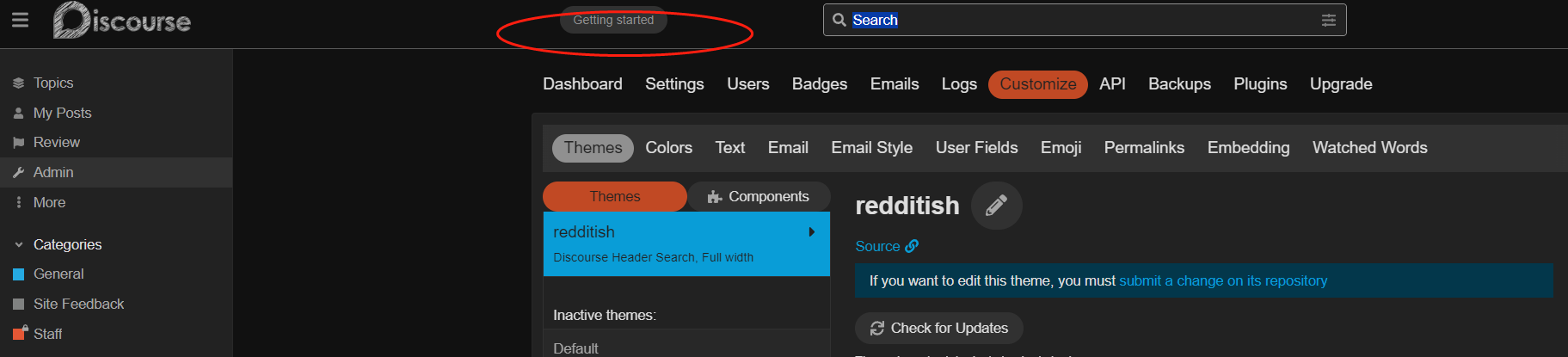

Seems the geting start doesn’t work. Could you please fix it? Thank you very much!! :smiley:

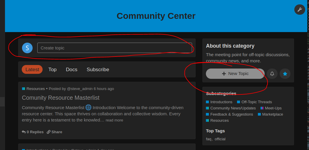

@awesomerobot This is an awesome theme! I really like it however I can’t seem to be able to create a new topic via the ‘Create Topic’ textbox, nor the ‘+ New Topic’ sidebar.
I cannot see any other comments that show others experiencing this issue so not sure if this is common or not? Does it work fine for you?

I have the last version of the theme and no issue creating topics.
Maybe it’s caused by one of your other theme components.
Do you have an error message in your browser’s javascript console from the developer tools?

Thanks for the prompt response and good suggestion; I do indeed have an error when selected New Topic.
Uncaught TypeError: this.composer.openComposer is not a function

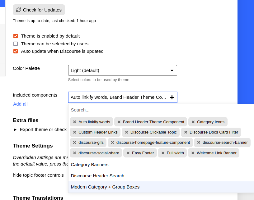

The components I’m using are:
Whether or not the components are causing the issue I’m not sure - I did remove all then try again and still had the same error upon clicking New Topic. Quite strange :thinking:

Yes, it looks like openComposer has been changed to open — I’ve just fixed this in the theme, so it should resolve once updated. Thanks for reporting it!

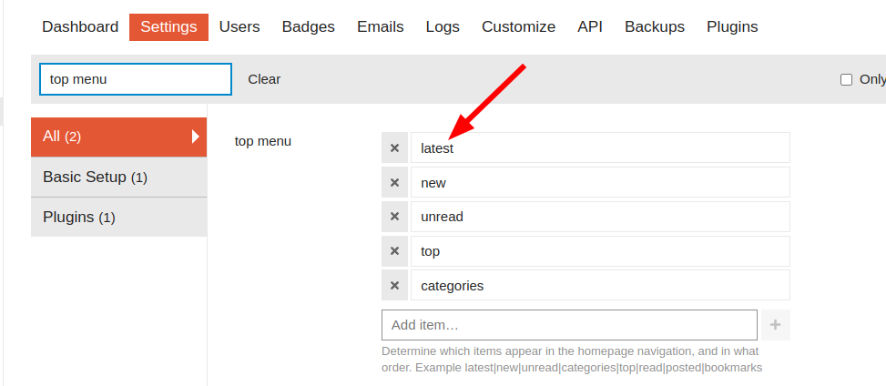

Just one question. It would be great if when people first arrived at my forum it looked like /latest
Is there any way to make that the default homepage kind of thing please?
Thank you!
I think what you are wanting to do is set /latest as your forum’s homepage. If that is correct, you can do that by setting latest as the first item in your top menu site setting:
