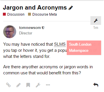

I’ve added touch capability to this plugin with some custom script and css:
With thanks to Scott Asbach for the original code
<head>:
<script type="text/javascript">
 * touchHover.js
 * Create tooltips on mouseover or on click (for supporting touch interfaces).
 * @author C. Scott Asbach
$(document).ready(function() {
	 * store the value of and then remove the title attributes from the
	 * abbreviations (thus removing the default tooltip functionality of
     * the abbreviations)
	$('abbr').each(function(){
		$(this).data('title',$(this).attr('title'));
		$(this).removeAttr('title');
	 * when abbreviations are mouseover-ed show a tooltip with the data from the title attribute
	$('abbr').mouseover(function() {
		// first remove all existing abbreviation tooltips
		$('abbr').next('.touchtooltip').remove();
		// create the tooltip
		$(this).after('<span class="touchtooltip">' + $(this).data('title') + '</span>');
		// position the tooltip 4 pixels above and 4 pixels to the left of the abbreviation
		var left = $(this).position().left + $(this).width() + 4;
		var top = $(this).position().top - 4;
		$(this).next().css('left',left);
		$(this).next().css('top',top);
	 * when abbreviations are clicked trigger their mouseover event then fade the tooltip
	 * (this is friendly to touch interfaces)
	$('abbr').click(function(){
		$(this).mouseover();
		// after a slight 2 second fade, fade out the tooltip for 1 second
		$(this).next().animate({opacity: 0.9},{duration: 2000, complete: function(){
			$(this).fadeOut(1000);
	 * Remove the tooltip on abbreviation mouseout
	$('abbr').mouseout(function(){
		$(this).next('.touchtooltip').remove();
</script>
mobile CSS:
.touchtooltip {
	position:absolute;
	color:white;
	background-color: #FF9999;
	font-size: smaller;
	padding: 4px 8px;
	box-shadow: 2px 2px 2px rgba(0, 0, 0, 0.1);
abbr {
    border-bottom: 1px black dotted;
8 лайков

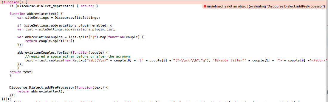

I’m getting a JavaScript error which I believe originates from the abbreviations plugin:
Looks like a similar issue (involving Discourse.dialect_deprecated) to what I had with the discourse-solved plugin - @eviltrout fixed it with this commit
https://github.com/discourse/discourse-solved/commit/9b1ebaae912b7ce950f14cd96348a2e1dd4f7c3b
So probably a similar solution required here.
Since @BlackSheep is apparently no longer maintaining this plugin, it would be great if someone would fork it and make the necessary adjustments. :slightly_smiling_face:
