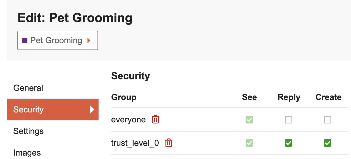

I’m unable to reproduce this issue both in a spec, or in my own tests, for example
Receiving category permissions
Post from remote actor in receiving category
Indeed, while they don’t have an email, staged ActivityPub users are like any other staged users, and will be given whatever trust level is set for the site setting default_trust_level.
