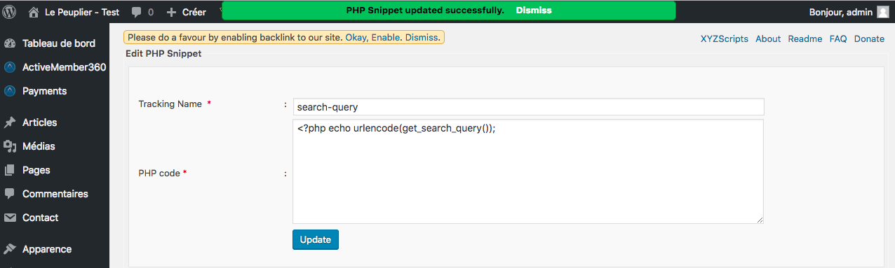

Try these steps:
  1. Install and activate the Insert PHP Code Snippet plugin
  2. Navigate to the plugin settings in admin (look for the “PHP” logo in the sidebar) and add a new snippet
  3. Set the “Tracking Name” field to something like search-query and the “PHP Code” field to <?php echo urlencode(get_search_query());
  4. Save the snippet
  5. Edit your custom search page in Elementor and replace <?php echo urlencode(get_search_query());?> with [xyz-ips snippet="search-query"] (replace “search-query” with the appropriate tracking name if you saved it with a different one)
Let me know how that works for you
3 Me gusta
It still doesn’t work. I completed the plugin part :

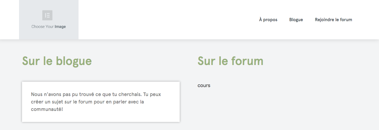

This is what I did. You can test it live https://test.lepeuplier.ca and write “cours”
OK, I see what you mean. So it appears you’ve switched from a HTML widget to a shortcode widget?
To verify where the issue lies, can you remove all the markup but the shortcode itself from the widget? I also noticed there is a leading space character in the snippet attribute of your shortcode. I’d assume the parsing would trim that, but I’d remove it just to be sure.
If it’s executed correctly, then when you load the search page, you should just see the search term rendered to the page, which means there’s some issue in how the widget is processing it. If you only see the shortcode, then the shortcode itself isn’t executing correctly.
1 me gusta
Yes I tested it with a HTML widget, it does the same result.
I tested only with the shortcode and I only see the search term. So it means that there’s some issue in how the widget is processing it?
Yes, that’s correct. I don’t know how the shortcode widget handles regular markup as it’s only intended to process a shortcode directly. The HTML widget should also execute any shortcodes present, but it might be confused due to the shortcode being wrapped inside an HTML attribute. In either case, I think the easiest solution is to put the entire iframe markup inside the shortcode, which should allow you to render it in either widget.

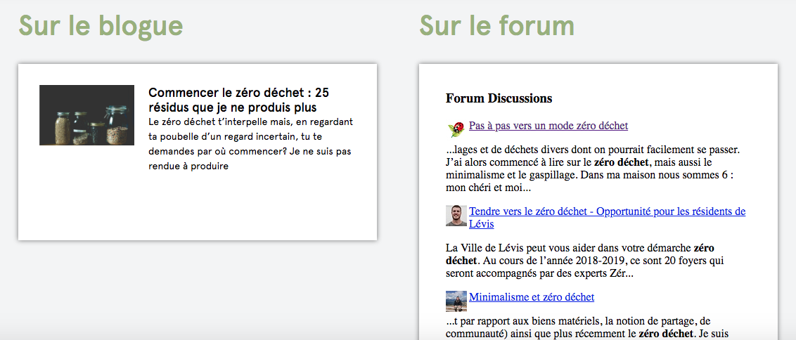

YESSS! It is working haha thanks so much! :smiley:
How can I change CSS settings (font-size, font-family and the avatar in circle)?
1 me gusta
Try replacing the code in discoursesearch.php with the following:

Again, this code is untested, so do make sure you backup before editing. These changes should hopefully allow you to add your own CSS rules directly in the file, whereas the original code would be more difficult to add your own styles to.
3 Me gusta
This is perfect! Thanks again for your time, it is so appreciated! You made a huge difference for my site :smiley:
