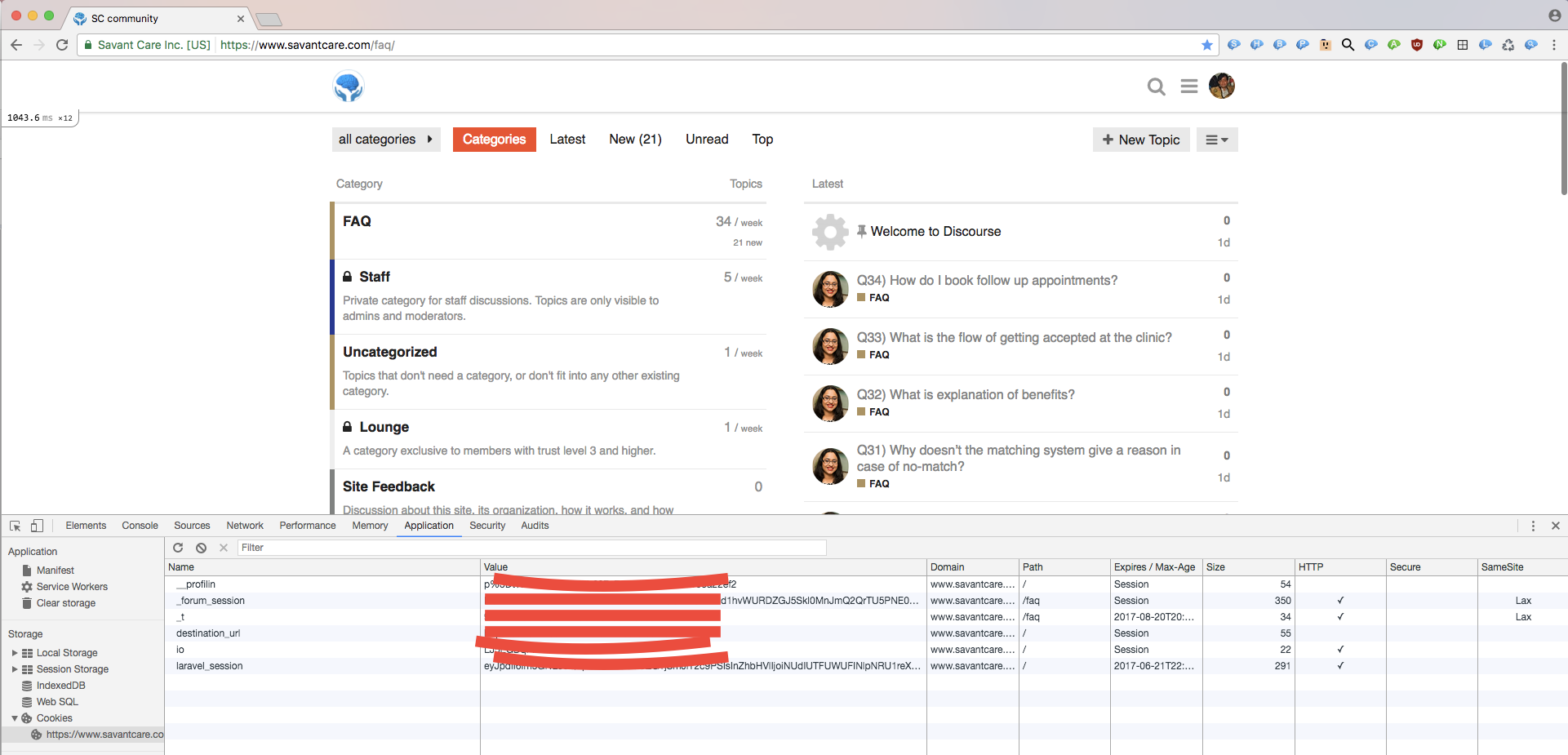

@sam I took your suggestion .. deleted all the cookies and I still hit the bug.
Please see the attached video:
I can go back and forth between two sites at the same domain, different subfolders, and I don’t see anything out of the ordinary hitting the auth logs.

So you deleted your cookies but still have the problem?
yes .. I wanted to make sure I did it .. so I also recorded it in the video
Hmm, the problem definitely goes away for me when i’ve cleared cookies. Do yours look like this now?
Yes !!
