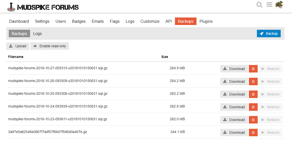

Our /admin/backups page (or rather then underlying request for .backups.json) takes about 50 seconds to come up each time, so it looks like the culprit of why the dashboard times out.
There are six entries in the ‘filename’ list for us, as we only keep that amount of backups rolling in S3 for 7 days.
At a guess, it looks like when calling S3 for a file list or file size then it’s taking about 10 seconds per entry. Perhaps something changed in the AWS S3 client library recently?
The backups to S3 seem to be working ok, which is good, as I did a manual backup and it worked.
One ‘funny’ is that there is a new entry at the bottom of the list, perhaps showing some mismatch between what’s in the DB and what is actually in S3?
Note: the odd ‘3a97e..gz’ entry at the bottom.
