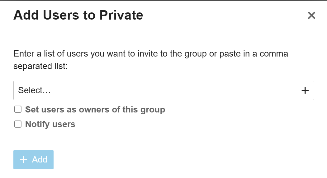

If you have a list of your usernames or emails (e.g. from the Export via /admin/users), you can can simply copy and paste this into the image bit of the Group page.
Easy peasy!
From memory, it struggles if you have over 1000 users. But you should be okay.
Thanks @nathank
Looking at the dialog, as worded it does read a bit like that might just create invites for those users, rather than actually shifting them?
It is clever enough to add those with existing accounts, and send invites to those who don’t.
I know because I requested it! But yes, the copy could be better, eh?
Go and test it with a couple of test users.
Thanks @nathank. It worked just as you said, and yes it is quite clever!
Happily recognized a windows clipboard copy of a cleaned up column of email addresses from Excel as comma delimited when I pasted into the dialog.
In my case I got ‘Error 502’ quite a lot even with pasting in just 500 users at a time - seems like this is a server bottleneck issue (my hosting plan has limitations on network and cpu utilisation).
Reducing that to 200 users at a time pretty much consistently worked, though if I left it longer between batches, I could get away with a few more at a time.

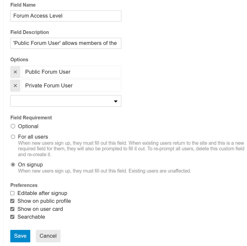

OK, an update
I finally got Discourse Automation to work - the trick was to use a drop down custom user field type (even though the instructions don’t spell this out) rather than the tick box field type I had started with. The drop down options need to correspond exactly to the full user group names
Very important - ensure this new field is not user-editable after sign up, otherwise a user signing up and being approved only for the public forum can later just unilaterally grant themselves themselves acess to the private forum.
