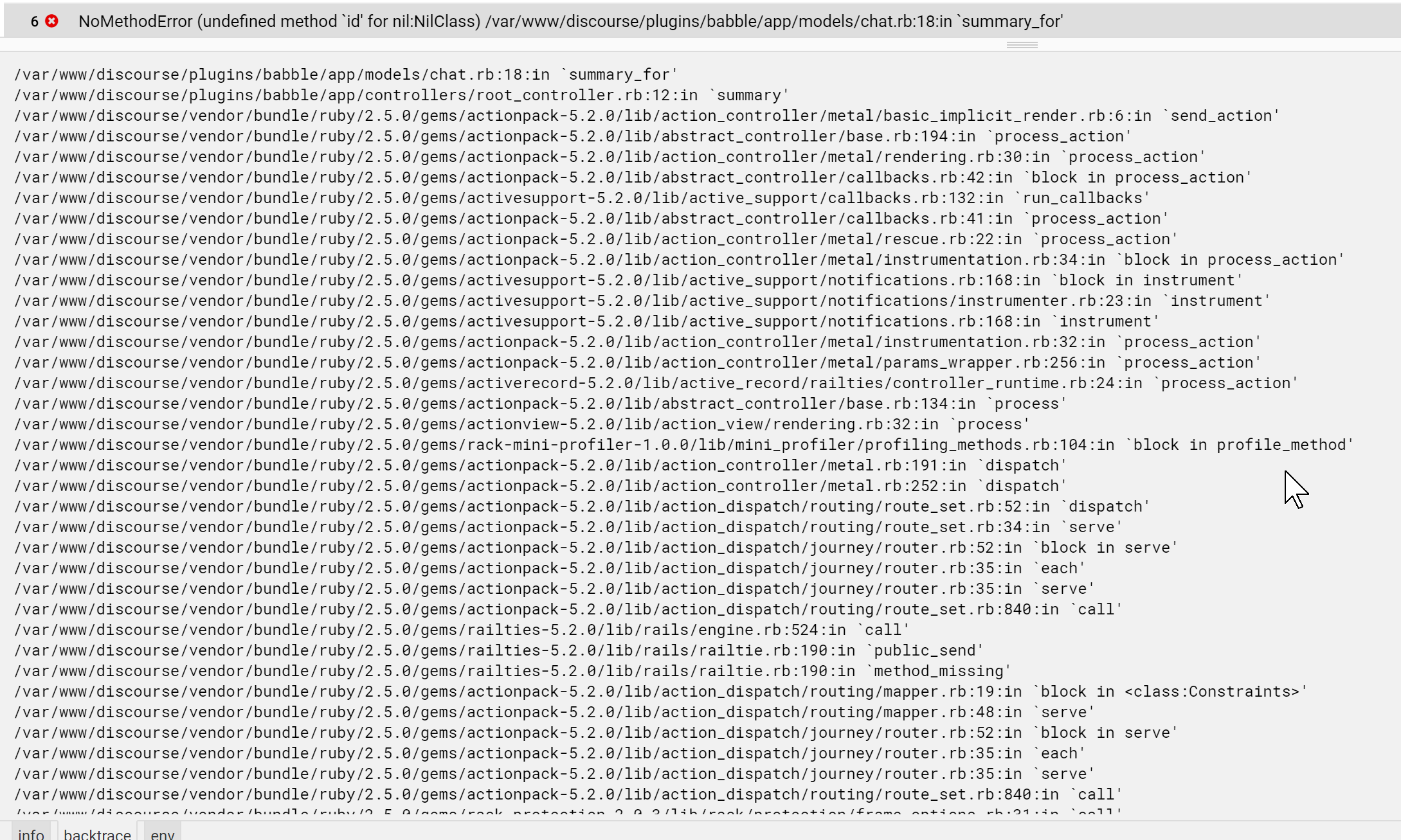

However, I’m unable to test this change as the latest Babble commit breaks on our dev instance running Discourse stable. See the log below:
Message
NameError (uninitialized constant User::HideChatNotifications::DB)
/var/www/discourse/plugins/babble/app/models/user.rb:26:in `unread_notifications'

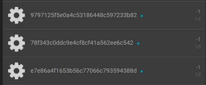

It’s really weird, but somehow I can’t see or just delete any topic created by Babble Plugin which was removed before:
