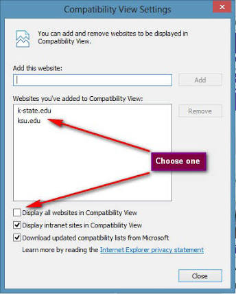

Not sure if this is helpful / or you already know, but to disable compatibility mode, go to tools > compatibility mode settings and uncheck the display intranet site in compatibility view setting / or remove the discourse site from the compatibility sites list.
Unfortunately, changing Compatibility View Settings in our corporate environment is not possible due to restrictions and some other issues.
