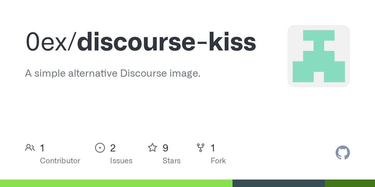

Hello @AquaL1te,
I have done some of what you are suggesting. It can use podman, k8s or docker. Rootless is supported (not fakeroot). It uses a 4 container setup with nginx, sidekiq, redis and the ruby daemon.
In general, the developer install docs can be followed.
One thing to keep in mind is there are some tricky aspects around how discourse does assets.
Ah, yes. I was confused with the terminology, I’ve been using Singularity a lot lately which uses a --fakeroot flag.
I’ll have a look, it sounds very nice! Because I prefer to use Fedora CoreOS for this, to max out the security potential of a containerized setup. This is not easily possible at the moment in the current setup.
It still bugs me a that the main solution is non-portable and there are no signs towards a modern solution. I’ll have a more detailed look at your setup and maybe in the future I’ll contact you to co-maintain it. If needed of course. Thanks for your work and suggestions!
