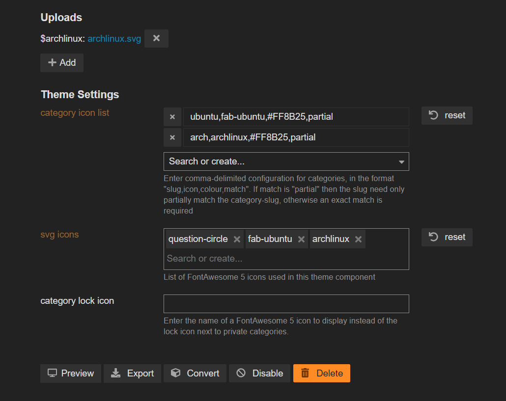

I am having trouble to use my custom icons. I didn’t get anything that could tell me should I use a prefix or not. Here’s what I am doing.
Here’s the SVG I’m using - https://andronixforumupload.ams3.digitaloceanspaces.com/original/1X/bdabc28a604dc98bb25ce8af2ef6f8dc7c9f2626.svg
As you can see I can’t see the arch icon at all.
  1. Create a SVG spritesheet: Replace Discourse's default SVG icons with custom icons in a theme
  2. In your theme component, upload your spritesheet and set the variable name to icons-sprite:
  3. In the component settings, use the id of the desired icon from your spreadsheet. For example if I have an icon id named my-icon in my spreadsheet, I write this:
Result:

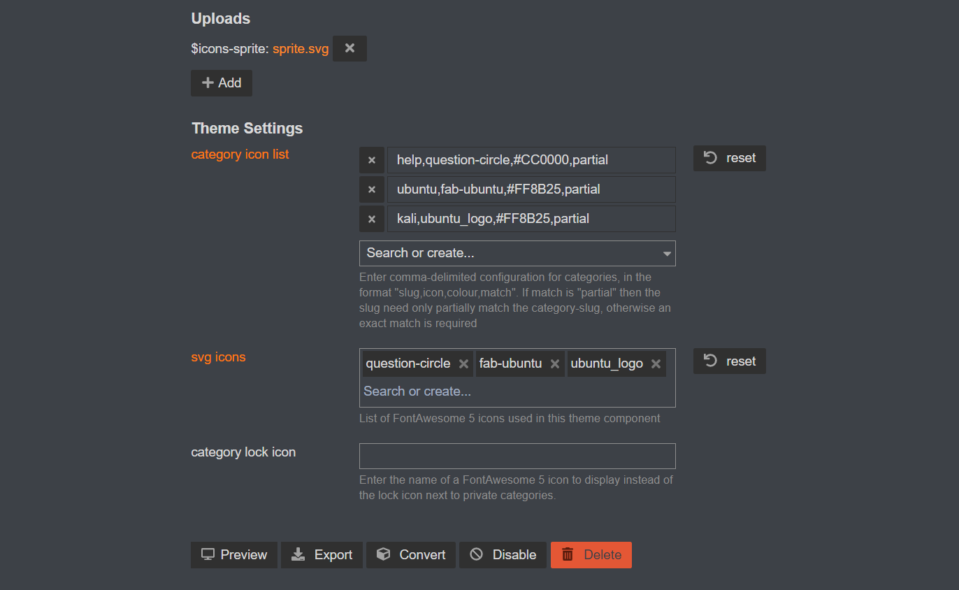

@Canapin That doesn’t work. Here’s my sprite file - Sprite File
The image id I am trying - Here
Here’s what I am doing-
Am I doing something wrong?
In your spritesheet, try replacing:
<svg width="0" height="0" class="hidden">
By:
<svg xmlns="http://www.w3.org/2000/svg">
Also there is no need to add the icon id in the svg icons setting fields all your custom icons are already availables from your uploaded spritesheet.
I believe svg icons setting is meant to load additional Font Awesome icons as Discourse only loads a defined, small set by default.
@Canapin Thank you! it worked like a charm. I have one more question though, is this sprite file exclusive to a particular component or I can access the icons with their ids anywhere?
When you upload a file to a used theme or a theme component, you can use it in any other, so I guess you can use your icon ids anywhere.

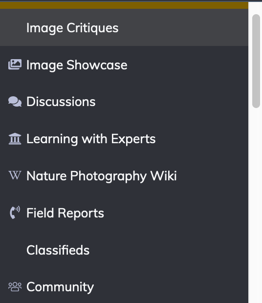

Here’s an example with it set to light. Image Critiques has the icon comment-alt-edit and does not display (which is a pro icon), Image Showcase has the icon images which is not pro, but is displaying the regular version, not light. Discussions is showing the solid version of comments, and Community is showing the light version of users as expected.
I tried changing one of them to cog, and it works as expected with the proper light version, lots of oddness going on here!
Did you try with far-comment-alt-edit?
Okay I got it now, the key is having far- in the category icon list, not svg icons. So for light icons I have to change them all to fal- and it does not follow the site setting for fa icon style correct?
