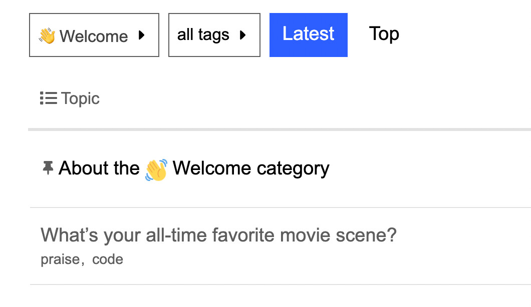

I actually would love if this let me also put emojis instead of just FontAwesome icons. Is this currently possible?
The example is I want to have a Welcome category and I think the :waving_hand:t2: emoji seems to be a more and more standard way to do it.
You can add an emoji to the category name using your native emoji picker in your OS.
Ah, that seems simple enough :smiling_face: Thank you!

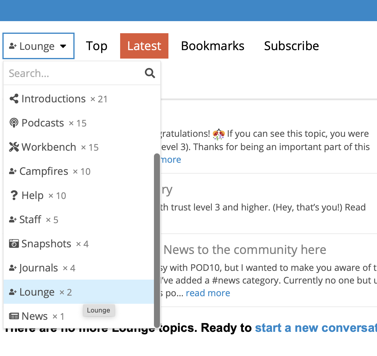

I’ve specified a Font Awesome icon to replace the default padlock icon. Curiously, it appears to be smaller than the other icons… Makes for wonky alignment of the text (in addition to the icon itself being extra-tiny) in category dropdowns and in the ≡ menu’s category listing…

Discourse-team gave me a little work-around that can be added to Theme CSS:
// FIX - New lock icon on private categories
svg.fa.d-icon.d-icon-user-plus.svg-icon.svg-string {
    font-size: 1.3em;
    align-self: center;
