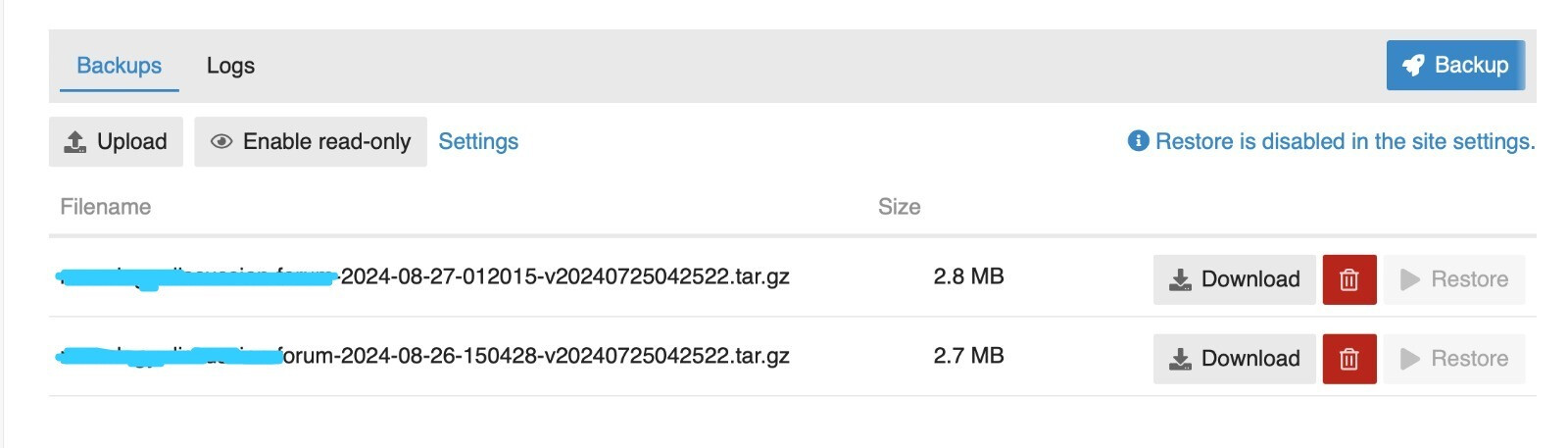

I too tested a setup on multisite and also think that it’s working.
I’ve seen something that makes me wonder if you can get a list of backups. I’ll try to check my setup.
I can see the backups listed. Havent tried the restore though.
