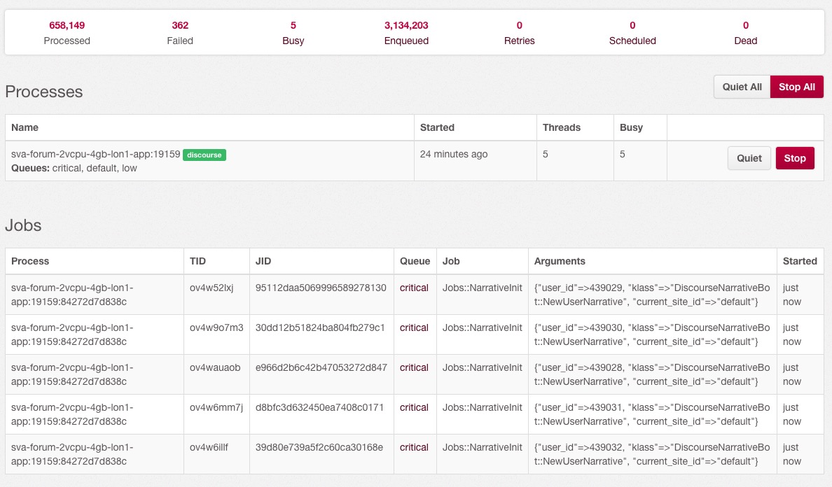

Click on the ‘Busy’ tab at the top of the /sidekiq screen and you’ll see your queues and the jobs inside them. Each job also shows how long it’s been active, which is a great indicator of problems.
I assume your Critical queue jobs are getting handled first, but let’s confirm that these are indeed the jobs that are causing the slowness.
That was one of those it can’t be that easy moments :rofl:
OK, so it looks like things are processing, nothing seems to be obvious in terms of hold ups:

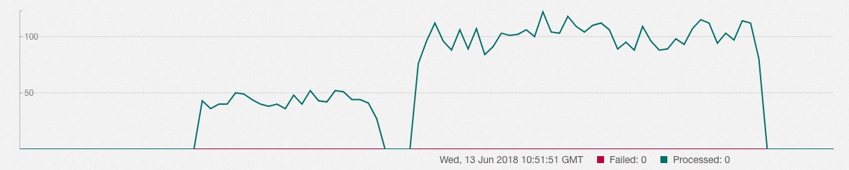

Thanks again @bartv, I’ve added UNICORN_SIDEKIQS=5 to the app.yml and run ./launcher restart app now looking back at the sidekiq dashboard it’s still only processing around 10 per second.

OK so I updated the Unicorn Sidekiqs to 5 and this temporarily doubled the speed to around 10 per second, until the server fell over again.

I’ll try adjusting the number to see if I can get a stable increase without the server bugging out.
