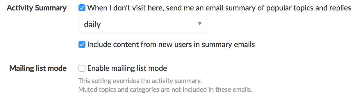

Can you or @sam suggest how I can set the following settings for all users (via the console):
I realize that some of these will be taken care of automatically if I upgrade, but I don’t want to do this yet as I got pushback from my community about dropping the daily digest. I’d like to try out a more frequent activity summary though before deciding, though.
The first checkbox is taken care of by what I posted above, the rest should be an easy extension :slight_smile:
