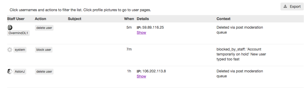

Have you checked the Staff Action Logs area? I can’t recall if that helps identify the cause.
Yep, it just says Deleted via post moderation queue
It does actually differentiate between the two:
So looks like TL0 restrictions need to stay in place… for now..

Quick update to say in the last 24hrs there’s been 9 accounts blocked by moderation queue and 8 accounts blocked by typing too fast.

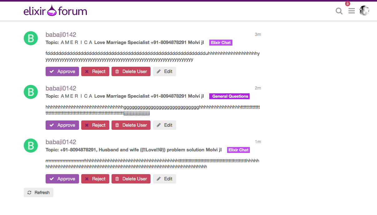

try turning off tl0 moderation queue and see what gets through, paste some screenshots here of spam that sneaks past.

Hi Sam, shall I keep it on (so our Twitter feed isn’t affected) but take screen grabs and post those here if the logs say it’s a TL0 related incident?
Here’s the first lot:
That’s the entire thread content (so title spam).
Based on what we’ve seen so far, a large string on numbers (I assume tel numbers) is present in nearly all the threads. I wonder if we could use custom spam rules (actually I think XF has this feature) so certain things can trigger posts or threads to be put in the moderation queue.

One sec, did any of the spam actually land, it is hard to tell if the fast typing would have caught it anyway.
Also no idea how that is passing the built in entropy test for body. Did you disable that?
4 « J'aime »
According to the logs, it was caught by TL0-moderate. Previously others have been caught by fast-typing so I assume fast typing is checked first? If not I can disable our Twitter-poster and turn the TL0-moderate off for a few hours to see if they continue to get caught (probably tomorrow as the weekends are our quietest periods) - just let me know if you need me to do that.
That would be cool - there’s definitely a pattern, but it’s only in the titles at present.
I had changed them to 3 (not sure why :/) reverted now :blush:
