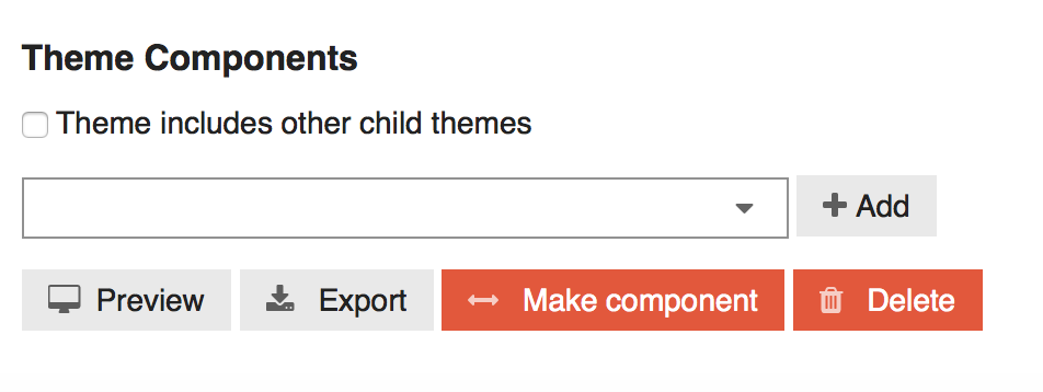

OK back up and working - thanks again - I’ve installed your theme and it’s installing as a Theme not a Theme Component??? any ideas. I’m on Version: v2.1.0.beta5 +66
You’ll want to click the “make component” button then confirm. You should then be able to add it to your main theme the way it’s outlined in the instructions I linked to earlier.
Fab, getting there! Making it a component works, but when I add it to my theme it adds a component with the others but there’s no text for the link, but the (x) button is there. The link it produces ends in a # where the others don’t??
and it doesn’t seem to work!!
Ah yeah, I think that might be a little bug that’s still getting worked out. Try refreshing the page, then click the (x) if that blank theme component is still there, then try selecting the Force Mobile Homepage component again. You might also try selecting another theme component from the dropdown list, then open the list again and select the Force Mobile Homepage component again. Click the “add” button and hopefully that should do it!
