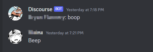

I have this issue as well, entering the discourse container and starting the rails c prompt causes another instance of the bot to spawn. Results in commands like Ping! returning Pong! twice and other things like not being able to change the username or nickname through discordrb.
Running the ::DiscordBot::Bot.discord_bot.stop command causes the instance spawned by rails c to exit but it can’t interact with the bot spawned when Discourse starts.

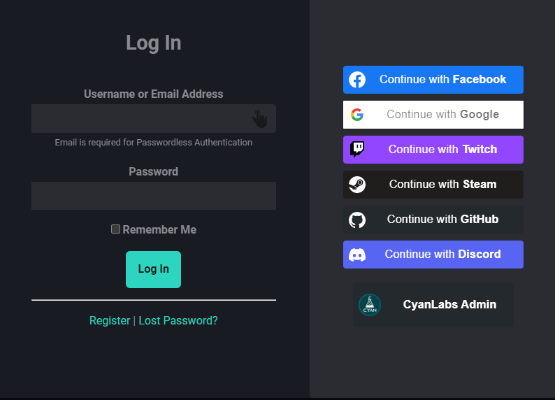

I also have an OAuth source that I need users to use instead of Discord. To get around this I have the Discord OAuth on per the OP but I’ve used custom CSS to hide all other login sources except the one I want my users to use with the display: none; CSS option. The ability to OAuth with Discord is ā€œtechnicallyā€ still in the HTML but a normal end user is never going to find it.
Users can then ā€œconnectā€ their Discord to the account my other OAuth source creates under their user preferences.
