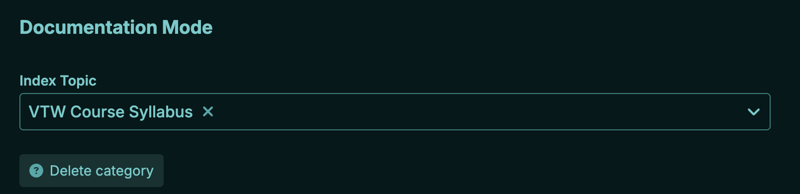

To make this work, I use standard Discourse features combined with the official Discourse Doc Categories plugin:
  • Course = Category: Each course gets its own category.
  • Lesson = Topic: Each lesson is a topic within that category.
  • Permissions: Members can reply to lessons (to ask questions), but only staff can create new topics.
  • Ordering: Lesson order is fixed by creation date. (Tip: This requires a bit of forward-thinking when posting lessons, or you can use the Rails console to quickly backdate topic creation times to force the correct sorting).
  • Syllabus: I use the Discourse Doc Categories plugin to designate an “Index Topic.” This index topic acts as the course syllabus/tracker and renders a beautiful outline on the sidebar when users enter the course.

Step 1: Install the Prerequisite
Ensure you have the official Discourse Doc Categories plugin installed and active. My plugin specifically only targets categories that have an Index Topic configured.
