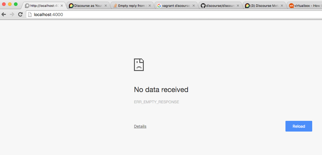

I just set up Discourse with Vagrant like the post says. I was getting empty responses
I fix it with running a server like so
bundle exec rails s -b 0.0.0.0
