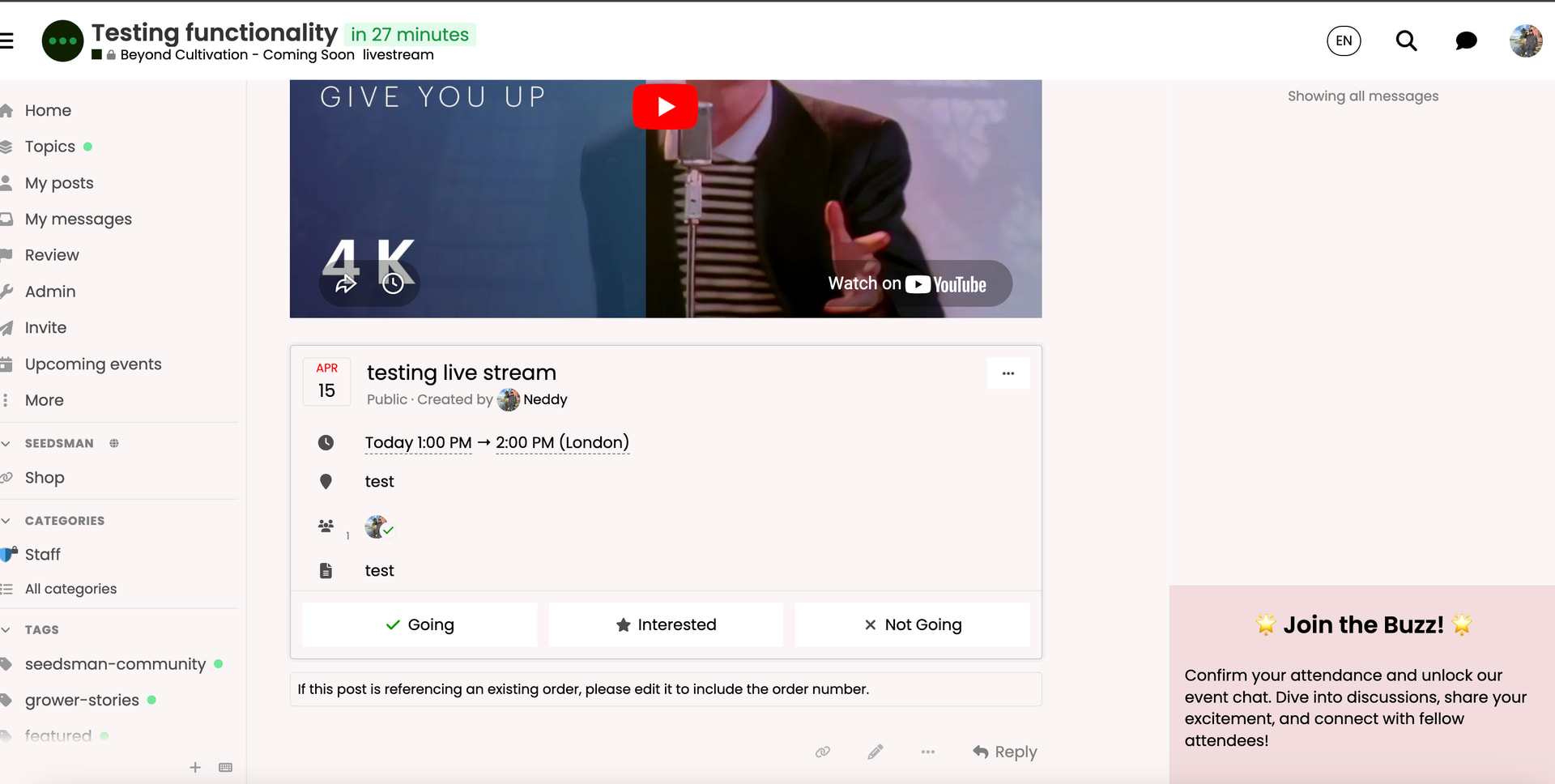

I used this on my forum to do a watch party for Sony’s State of Play. We really liked it, but I am a bit confused about what this plugin does exactly.
It seems me that the purpose of this plugin is to watch videos synchronously with others. It happens to be the case that we were watching a Youtube livestream, so our video feeds were synced… until the livestream was over. Changing the video time afterwards, the playback didn’t get synced to others. But, the original post has a screenshot of the rick roll Youtube video, so maybe it does sync the playback and I’m just not aware of how that works? It would be nice if it did so we could do things like movie nights.

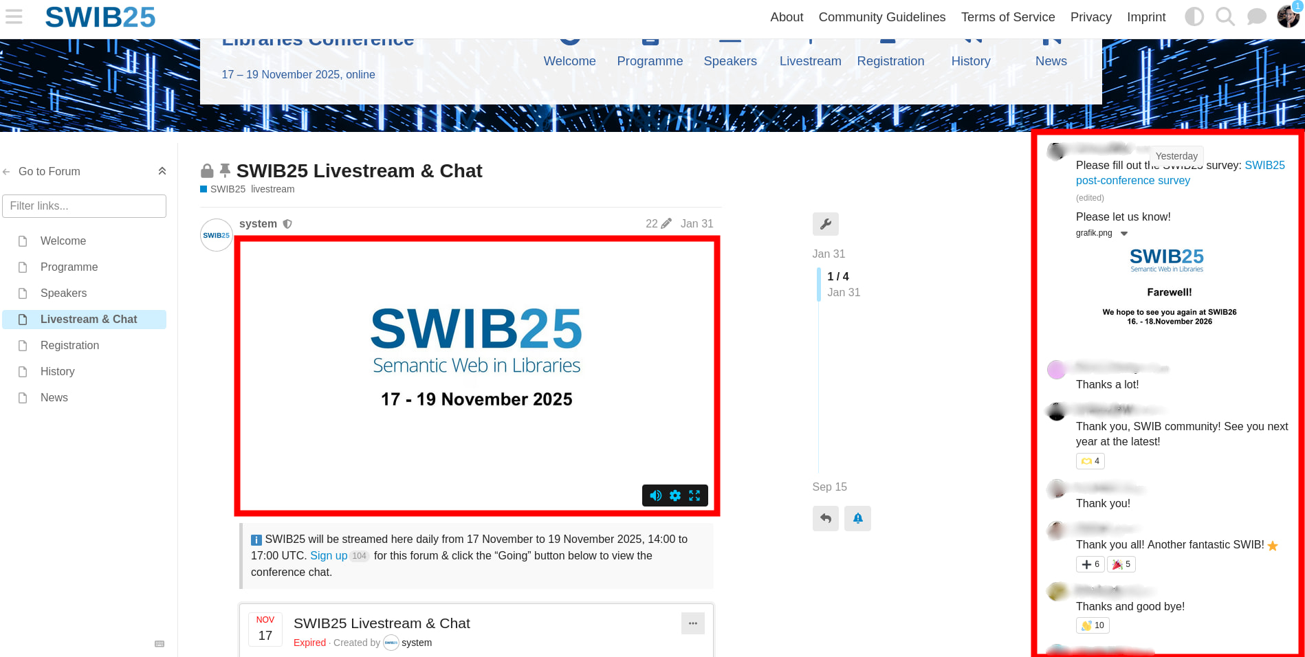

It would be nice if one can adjust the size of the chat like with the default drawer mode of the chat. And also the size of the embedded live stream.
Currently it looks like this
There is a lot of unused space. When you switch the livestream to full screen, chat is no longer visible and usable.
