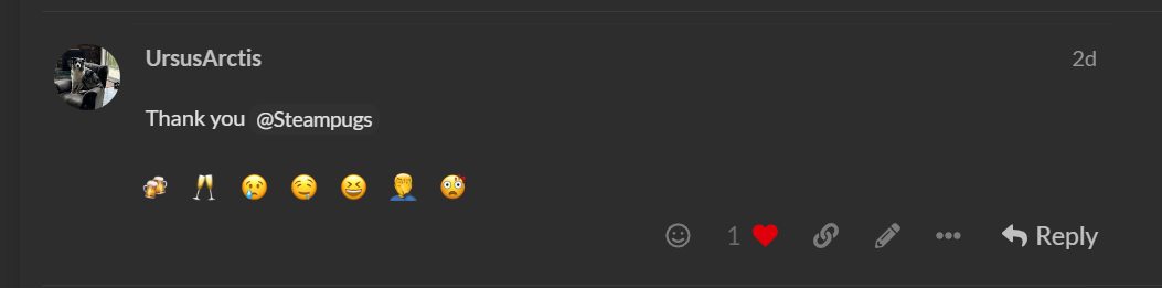

There was a change that ruined it, they moved the retorts in-line with the post controls, this ruined it on mobile, if the retort container stayed above the post controls like in this post Discourse Retort - #383 by Vaping_Community it would still be amazing, the ability to retort multiple times was a feature enjoyed by all

Ok so I did a thing but I have no idea what I’m doing… I’ve been using this plugin since 2018
@merefield Please advise how to credit on my GIT, I really have no clue on how anything works
Git is here: https://github.com/GrubbyVc/Retort-Reloaded
I cloned the retort plugin and edited it to display the retort-container above the controls again, this allows for multiple retorts on mobile. I wanted to change it only for mobile but didn’t know how.
Note: This is the only change I made
Change
Changed this line in retort-init.js.es6
api.decorateWidget("post-menu:before-extra-controls", (helper) => {
To this
api.decorateWidget("post-contents:after-cooked", (helper) => {
