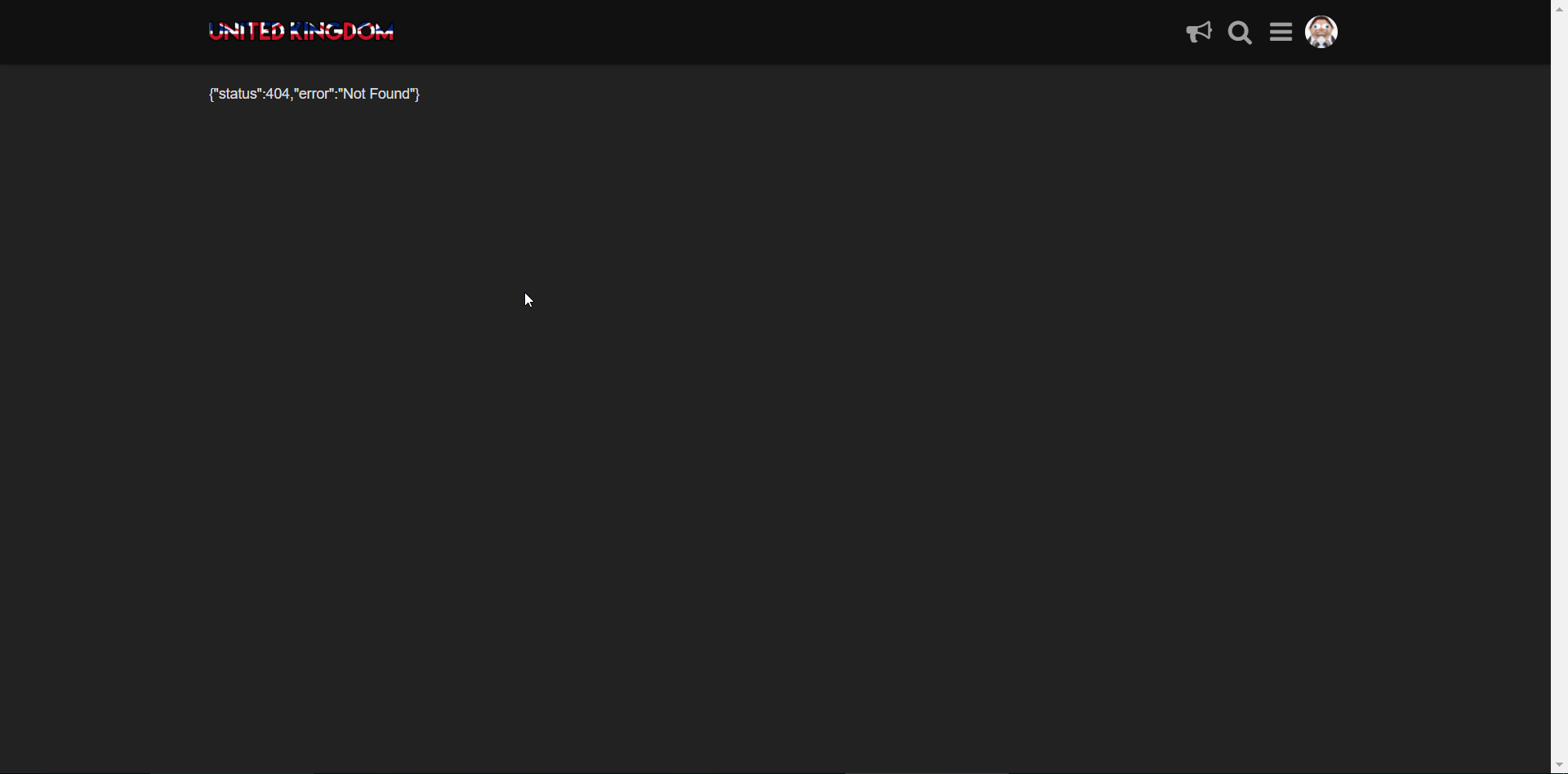

I am not sure if you’ve heard about this before, but here comes my story, haha. Today I installed your plugin and I experiemented with it. I deleted a thread with an election in it as I was testing the plugin itself, worked well. After I have deleted that thread I ran into a major issue for my website.
As soon as someone replied to a thread, or created a new thread, they would receive an error and the thread would just return a 404 error everytime you tried to access it.
Example:
I am not sure how this could’ve happened, but I really appreciate it if you would be able to help me out to fix this issue!
Cheers.
Ferry
Thanks for the report @JustFerry. There was an indeed an issue that arose if you deleted an election topic. It’s now fixed.

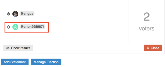

@angus If a user was nominated, then later is anonymized, their name in the election post will remain. Not functional problem but I would expect it to be scrubbed when anonymized.
Now when a user is anonymised, if they have any election nominations those nominations will also be anonymised.
https://github.com/angusmcleod/discourse-elections/commit/7bf1dfb468167125e85377e360ca5824b3f58a16
I opted to anonymise the nomination rather than remove it, as removing it would change the nominee count and have other knock-on effects. Retaining an anonymised nomination is consistent with other anonymization behaviour (i.e. anonymised posts are retained).
Example:

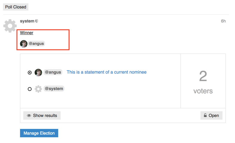

You can now identify a “Winner” of the election at any stage of the election process in the “Manage Election” modal.
  • You can only identify one winner.
  • I allowed identification of a winner in the Nomination and Poll stages, as there may be cases (see above) in which you want to identify a winner without a poll or while polling is going on.
  • Selecting a winner does not effect the election state, i.e. if you select a winner when the poll is open it will not automatically close the poll.
  • The Winner is identified under the heading “Winner” at the top of the election post (i.e. the first post). Examples:
https://github.com/angusmcleod/discourse-elections/commit/b922c1aa0297746ea416225e8fc1e5545500924d
