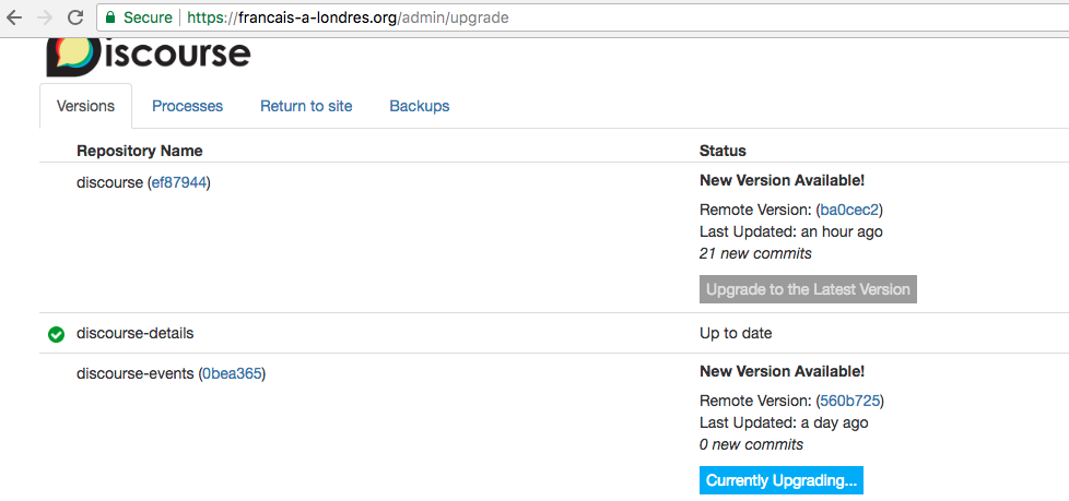

Hi @angus,
I hope you are well, thanks for the great plugin developpment. Just this little bug is that since 2 days the currently Upgrading status is not moving. I cannot stop it. Any idea ?
Many thanks

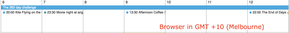

Sounds like you’re talking about events timezone default?
If you have that set, it will override the localisation to the user’s timezone:
In other words, if both events timezone default and events timezone event are disabled, the event will be localised according to the timezone of the user.
Here’s an example from my sandbox:
hm. I haven’t come across this issue before. I upgrade my sandbox via docker/upgrade each time I push updates for this plugin. It could be an issue unrelated to the events plugin, but let’s assume it is for now.
Do you see anything at yoursite.com?
Are you able to ssh into your server and rebuild the container?

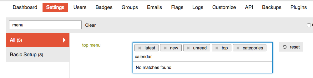

Thanks for this reply.
I think have created ‘calendar’ in the top menu site setting. Although I can’t see it appear and returning to it, it isn’t saved and won’t let me create:
I can’t find this?

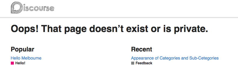

Inputting URL mysite.com/calendar return error message that the page doesn’t exist or is private.

Could you type “events” into the site setting search take a screenshot of the results and paste it here?
Also please post a screenshot of yoursite.com and yoursite.com.

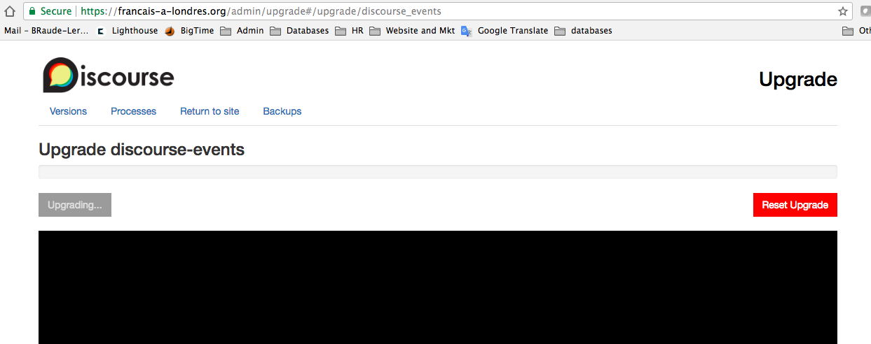

Hi @angus
I come back to you because i tried to :
  • ssh and rebuild the app
  • comment and uncomment the plugin line in the app.yml
and still on the below screen shot when i click on the reset upgrade button it doesn’t answer
1 « J'aime »
Do a full rebuild from the command line and then click reset upgrade. We fixed this issue.
