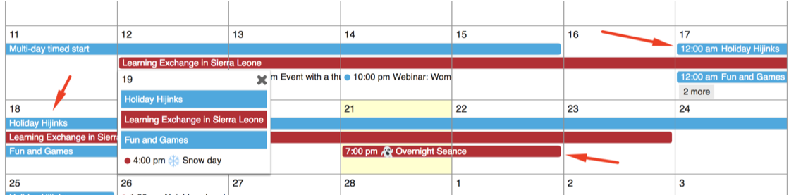

@tobiaseigen @ChrisBeach I’ve fine-tuned the event display to:
  • handle all the edge cases for all-day event blocks;
  • add titles to the start of each row for multi-day / multi-row events
  • Allow multi-day titles to take multiple cells;
  • Clearly delineate the start and end of multi-day events when multi-day events are back to back.
Yeah, one is US/Pacific, one is Canada/Pacific and one is US/Pacific-New (apparently it’s different from US/Pacific). I tried to do a bit of formatting on the timezone labels as some can be a bit long (i.e. remove the country), but it’s hard to come up with good formatting rules as timezones don’t have really have any universal conventions. I’ve removed the formatting for now, so you’ll just see the full labels.

awesome! looking good. the “select a timezone” issue is pretty minor.
I had a poke around in your sandbox and noticed a few oddities. See screenshot. one multiday event goes off the right side of the screen. The “x more” is showing on a day when there are only two events. One of those is pushed down on the day as well. I can see what you’re doing there but it looks weird - wonder how google calendar handles that use case?
I also added an event myself to the calendar and it’s not showing up.

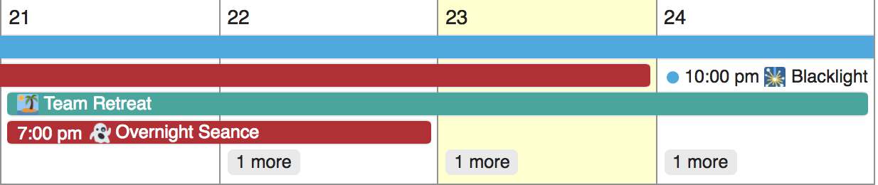

Arrangement of events
These are minor style calculation issues (fixed).
In most cases, the scenario you’re referring to here:
is necessary (the same is true in Google Calendar). This mostly happens because there are overlapping all-day events that end on different days. The plugin tries to ‘fill in’ when possible, but it can’t in a scenario like this.
If the hidden all-day event started on the 23rd, all of the events fit, e.g.
It’s a bit like a jigsaw puzzle.
There was one edge case which was handled differently in this plugin from Google Calendar, which is when there are overlapping all-day events that end on different days, causing a gap on a day in which there is also a normal event. In that case Google Calendar will ‘fill in’ the normal event.
I’ve updated the calendar sort logic to handle this case (see ‘Blacklight’ in above screenshots). I’ve also increased the height of day cells to handle 4 event rows and made some slight adjustments to the ‘x more’ style.

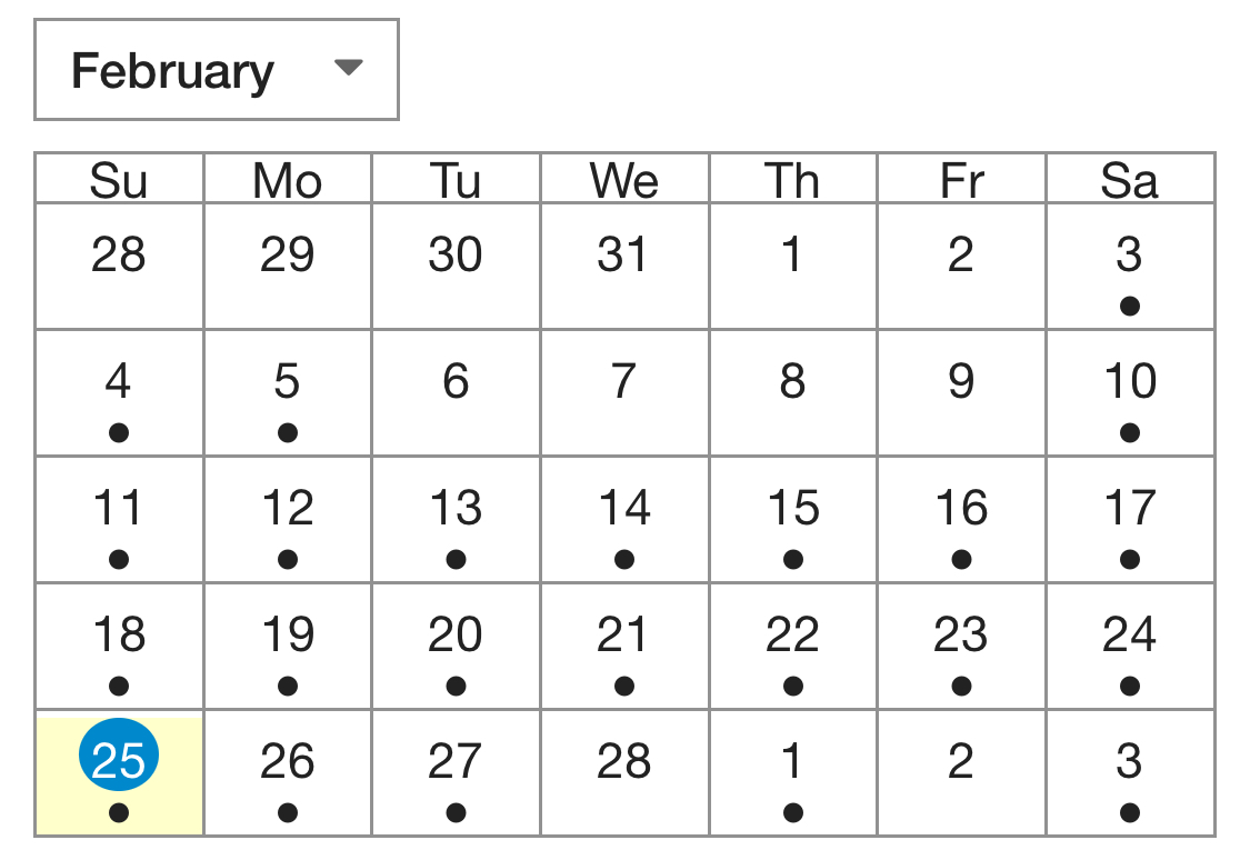

Minor bug: when clicking on a day in the calendar (mobile view), the calendar may switch to a different month (which is fine), but when this happens, the day selection highlight is lost.
Day highlight (blue circle) showing:
Tapped on the 1st March and now no day highlight showing (same with subsequent taps on days in March)
「いいね!」 2
Thanks @ChrisBeach, I’ll fix this in the next day or so.

Fixed: BUGFIX: selected date wasn't month-aware · angusmcleod/discourse-events@1c6c5bb · GitHub

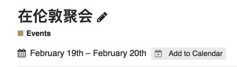

I can choose the end date, but the end date will not be displayed in my topic, only the start date. When you add to the Google Calendar, the title can only recognize English numbers and symbols, but my website is not English - based,so the title is empty.
@adorfer Thanks, I’ll have a look at these issues tomorrow.
@tran Thanks. I’ll have a look at the Google Calendar issue tomorrow. For the end date issue, could you give me some more details and / or an example? I just tested the functionality on my sandbox and it’s working fine, see e.g. https://discourse.angusmcleod.com.au/t/late-night-jamming/302
「いいね!」 3
@angus THX for replying. Amazing, the end date is normally now.
My language is Chinese, the title cannot be displayed in Chinese.
