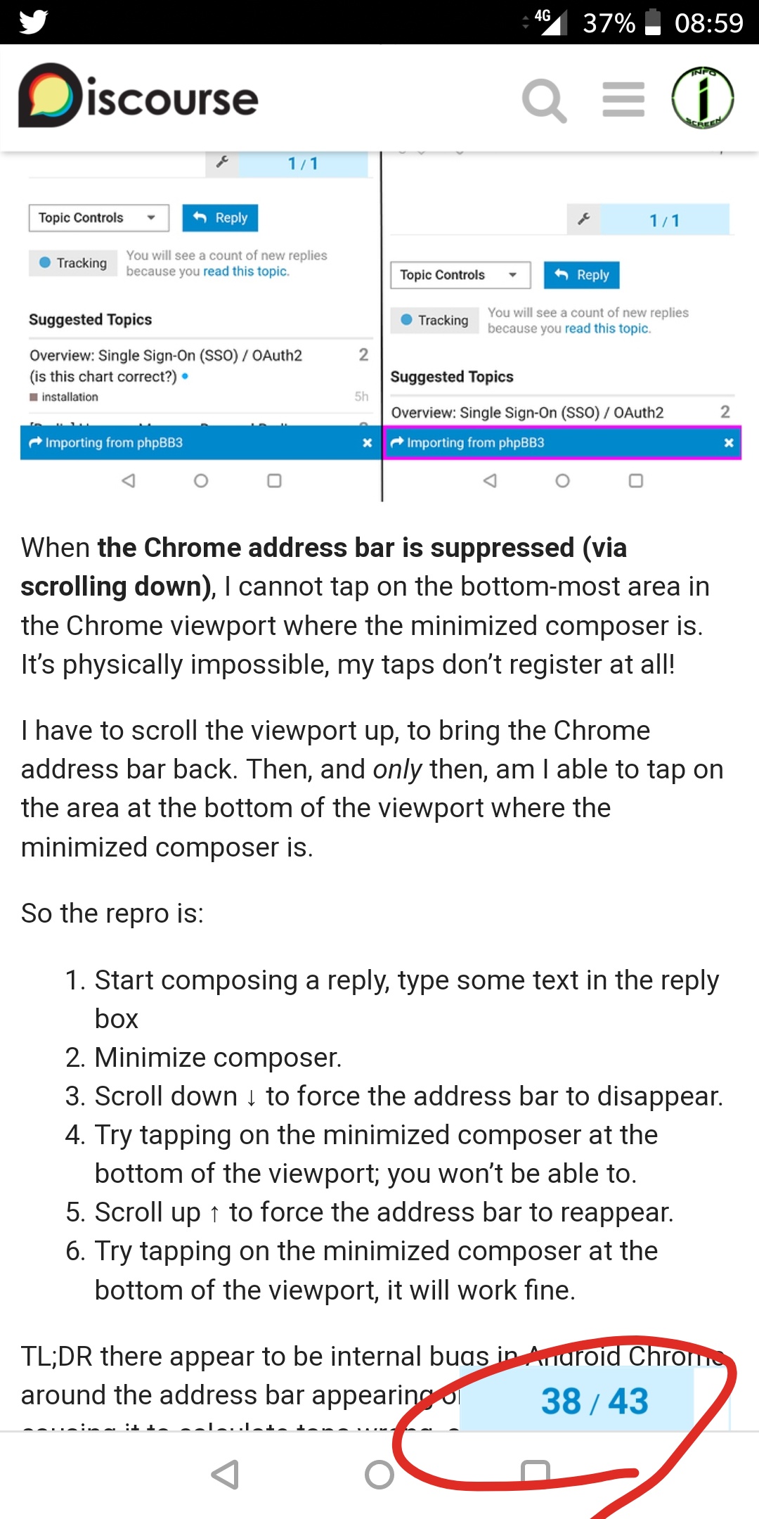

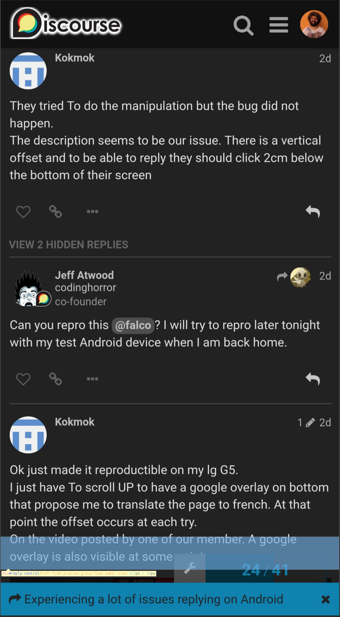

Where the div is when you can’t click on it if you trigger the bug going up.
It can be below too, if you go top → bottom.
Also, I can repro this same behavior with the bottom bar on Instagram. After the first infinity scroll (when it loads more posts) the bottom bar will become inaccessible, depending on if the location bar is visible.
Can reproduce too.
Also fails for the post counter sometimes, though it works other times

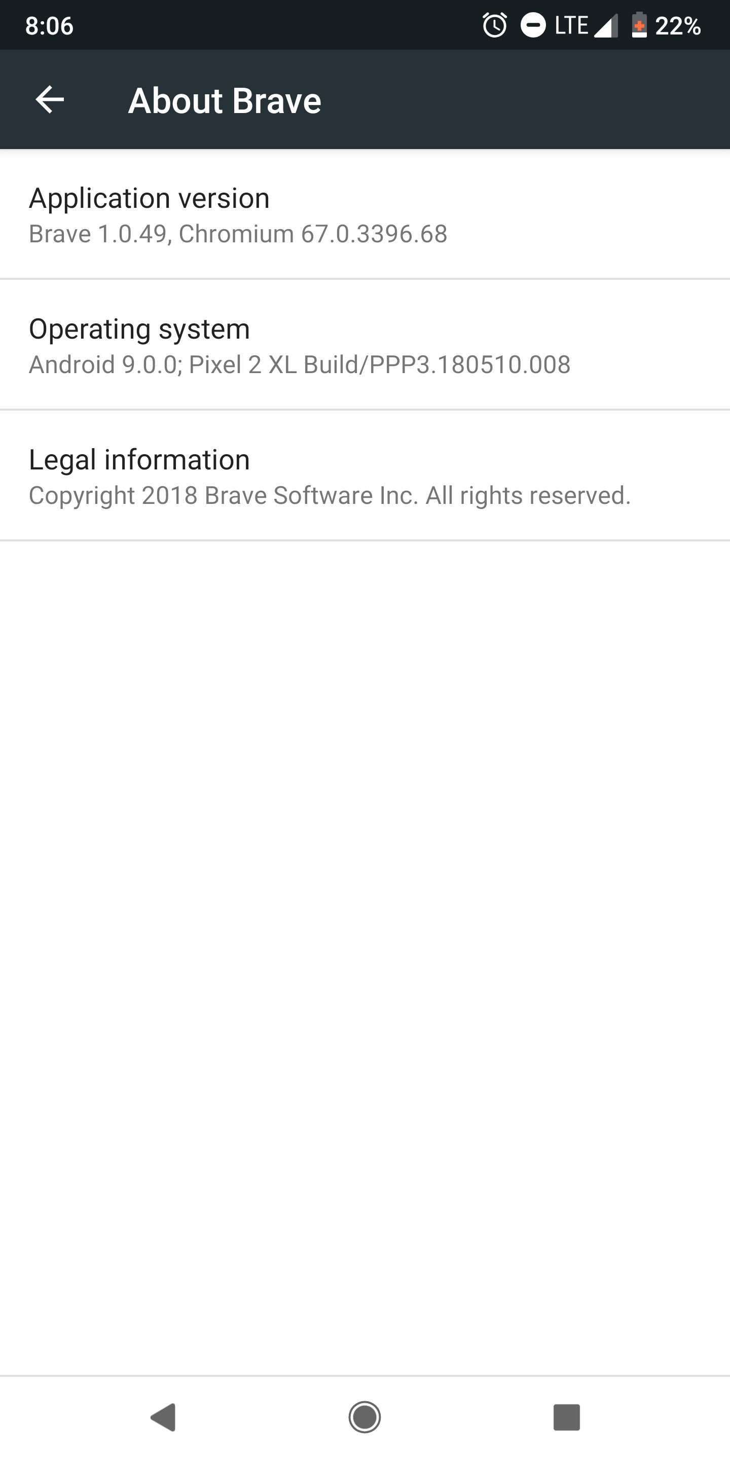

|Google Chrome|67.0.3396.87 (Official Build) (32-bit)|
|OS|Android 8.1.0; ONEPLUS A5010 Build/OPM1.171019.011|

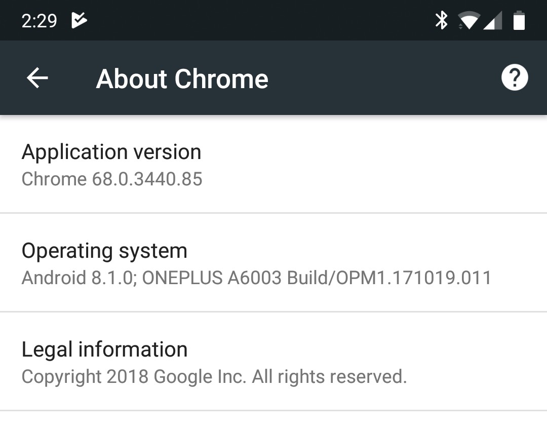

Chrome 68 is live with the fix. I can’t repro this issue anymore.
Google Chrome roll out is very slow on Android, so please check your current version before testing.
Definitely confirmed, just got the Chrome 68 update on my OnePlus 6
