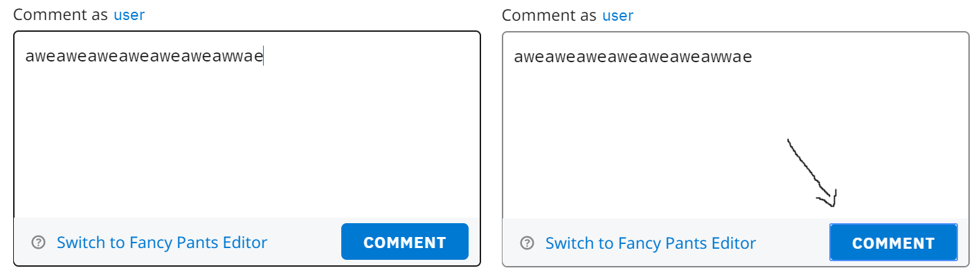

For example I just tested this on Reddit. After typing anything the comment button is enabled, pressing tab you are taken to the comment box. space then submits.

Sorry, I haven’t used reddit that often either. Here are a few examples that are contrary to this behavior are: github, mediawiki, Thunderbird, mutt, … (just to show that this is not necessarily the default in all UIs)

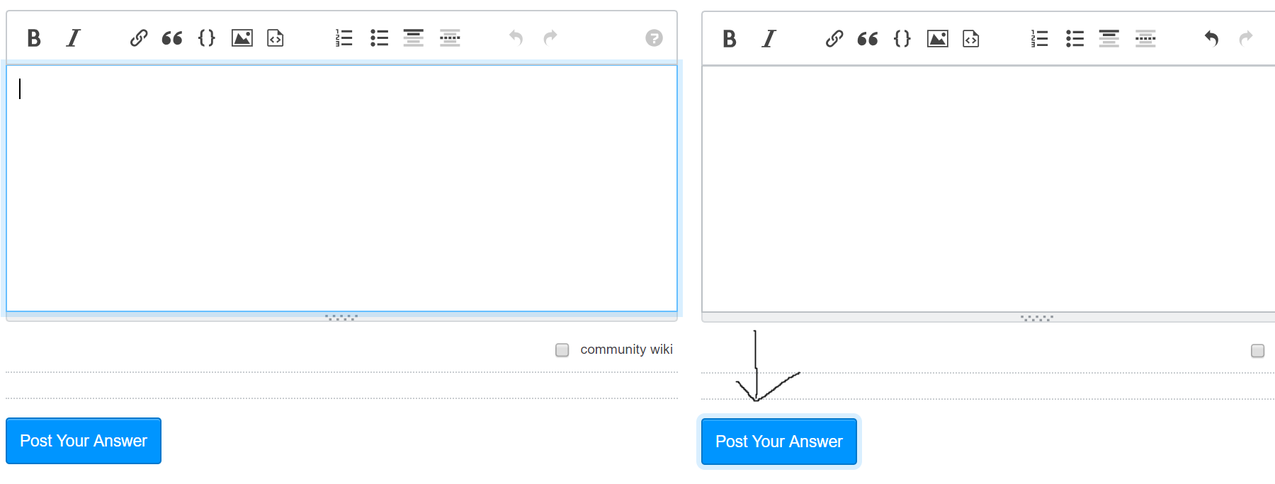

Tab also moves focus to the submit on Stack Overflow, so pressing Space at this point would submit the post there as well.
