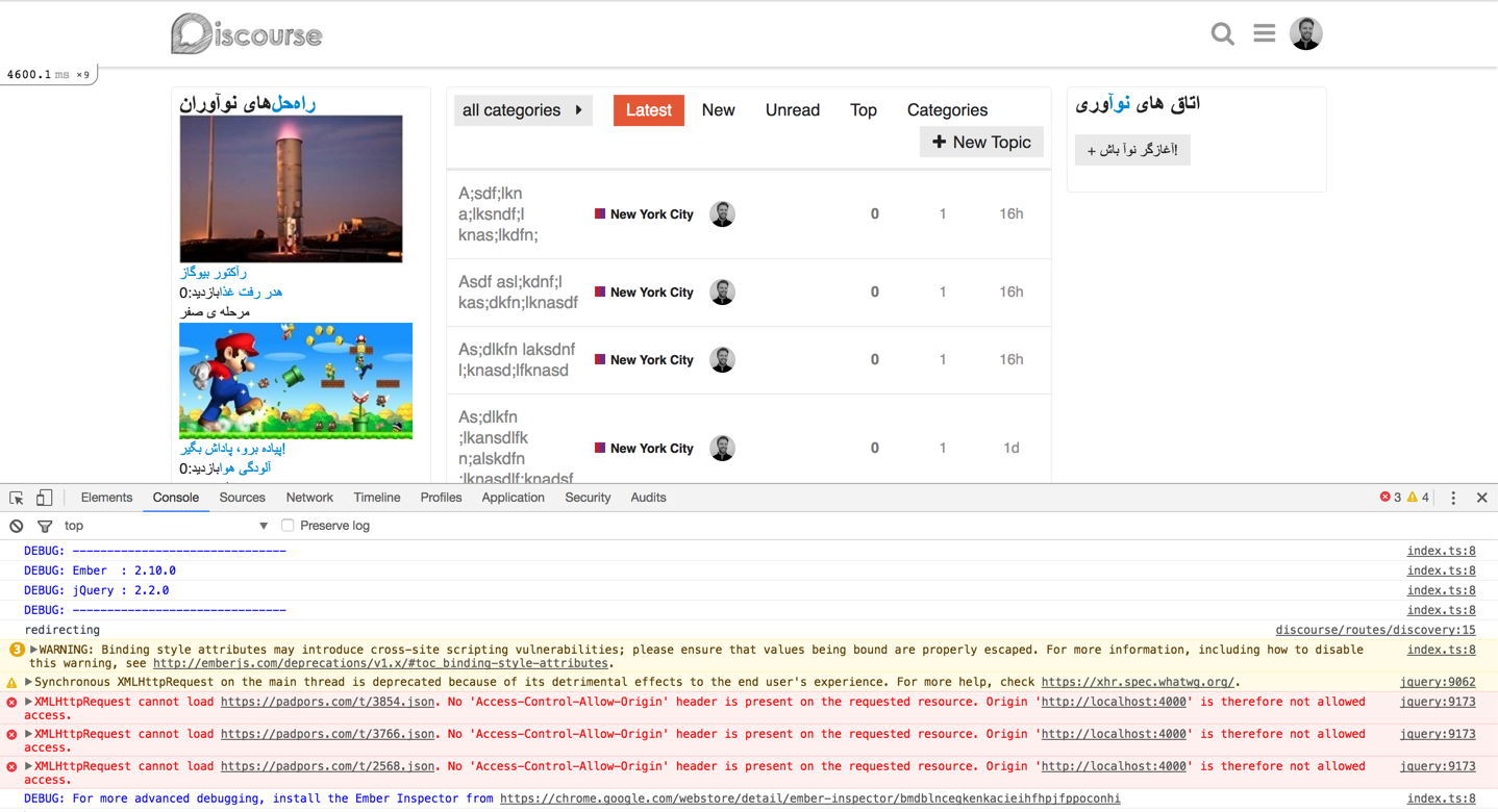

You have three issues.
One is that the widget file needs to be the same name as the widget itself. I have submitted PRs to your two widget repos to fix this.
https://github.com/Alavi1412/developing-answers/pull/1
The second issue is a CORS issue with some of the assets you’re using. I can’t fix that. You’ll need to update the CORS permissions or change where the assets are hosted.
The third issue is a bug in the developing-solution widget when viewing a discovery category route. I have submitted a PR for a temporary fix for the issue. It won’t make the content you want to appear appear, but it will stop the exception from occurring and the widget containers themselves will appear in discovery category routes.
https://github.com/Alavi1412/developing-answers/pull/2
Generally you need to look more closely at better use of Promises to handle all the ajax requests you’re making. You need to wait until the ajax request resolves before you can use the requested data, i.e. after the request add .then(function(data){}).
Handling ajax requests is a little tricker in a vDom widget, without Ember’s computed properties and observers. In fact there probably shouldn’t be any ajax requests in a vDom widget. Nonetheless, have a look at how I’ve done it in this widget.

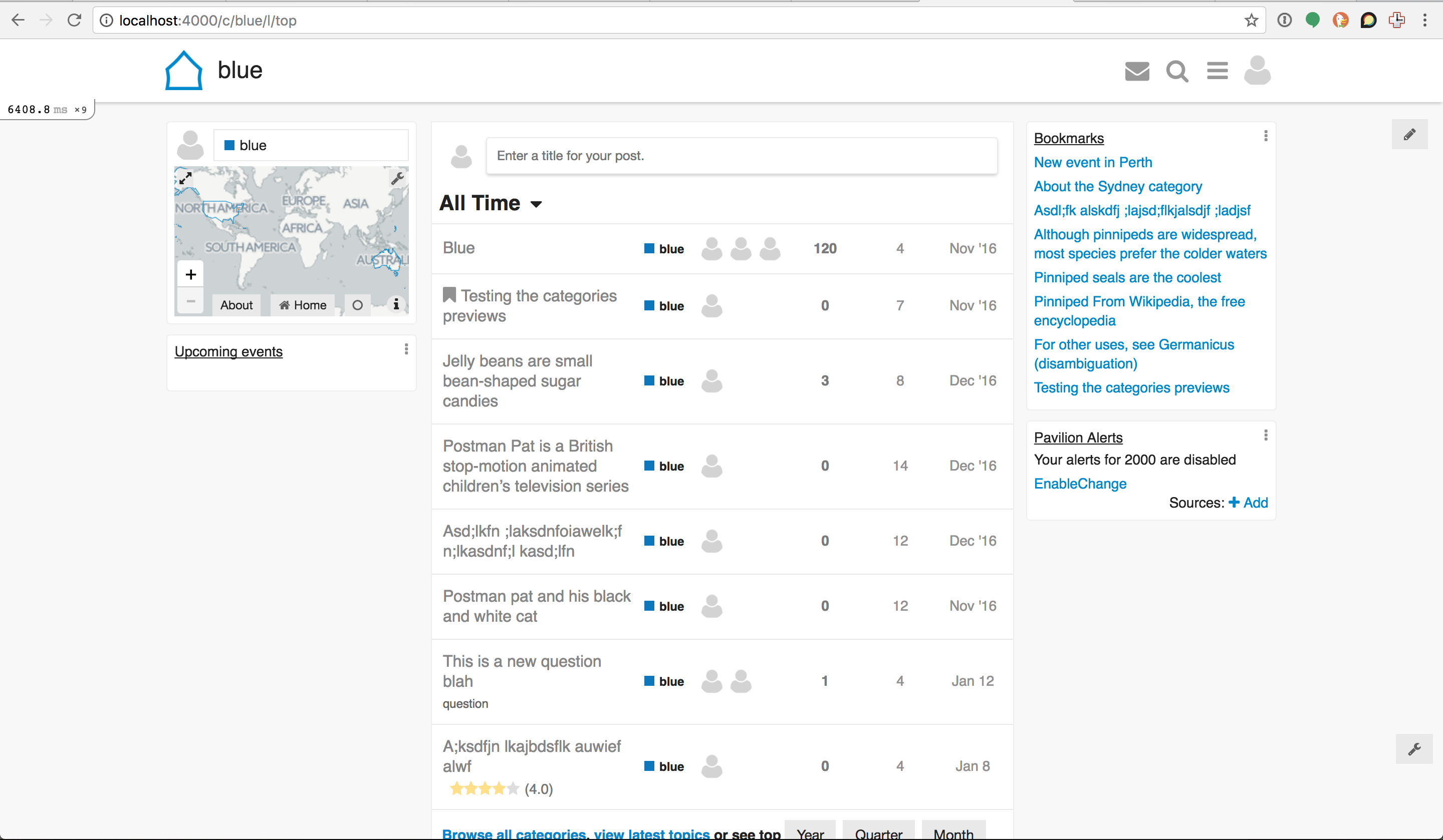

Could you send me a screenshot of it running over? This is what I see when I go to Top topics.
I was able to fix it.
.topic-list {
table-layout: fixed !important;
This is what was throwing over on mine. I’ll send you a pm with how it looked without it.
