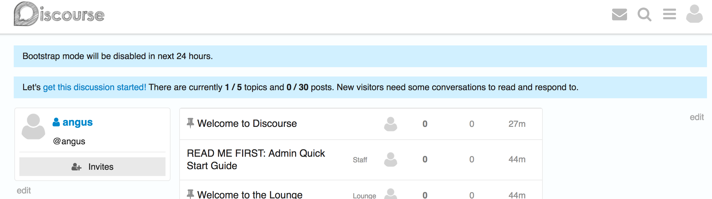

Hi, I’m wondering how to add such things in as the right banner.
  1. A calendar, better to have Schedule Function.
  2. An Editable Advertisement Place for showing the sponsor’s logos.
Can that be done?
Did someone make a list with widgets(plugins) created for this awesome plugin?

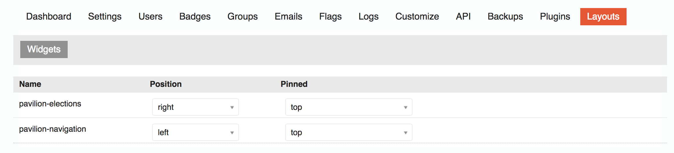

Note to users of this plugin (@Pad_Pors) . I’ve changed the way widgets are enabled and positioned. Rather than listing widgets in settings, you now select the position and whether the widget is pinned in a separate admin panel.
Instead of monkey patching the SiteSetting model, i.e.
SiteSetting.class_eval do
  @choices[:layouts_sidebar_left_widgets].push('profile')
end
You now add widgets in your plugin.rb like so:
DiscourseLayouts::WidgetHelper.add_widget('election-list')
This will make them appear on the list of widgets in the new admin panel.
