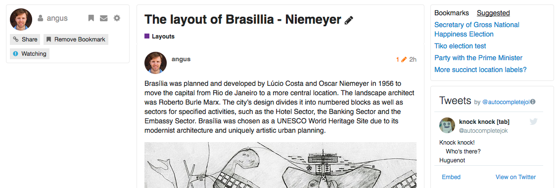

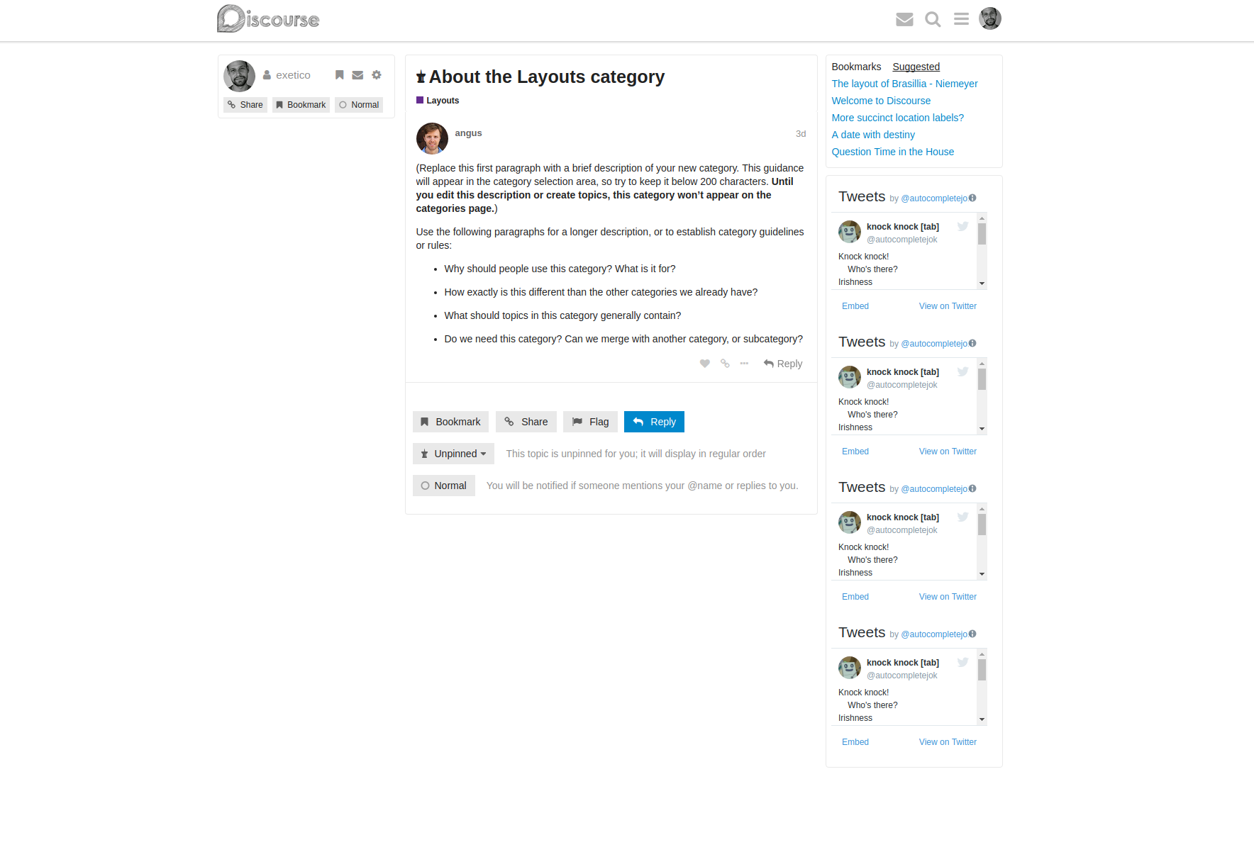

@exetico Yes that widget has taken various forms. I’ve cleaned it up and made it available again as layouts-topic-list.
https://github.com/angusmcleod/layouts-topic-list
You can list bookmarks and / or suggested topics (when viewing a topic). Both lists can be toggled with settings.
You can see it in action in the layouts category in my sandbox.
