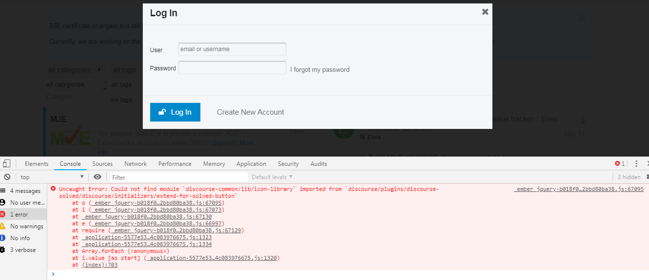

Last night, I have changed Discourse certificate from Symantec certificate to DigiCert, then rebuild the Discourse, and app is running, but LDAP button is no longer appear in home page (after clicking on “Log In” button).
But, it is possible to login to Discourse with “https://discourse.xx.xx.in/auth/ldap”. Could you please let me know if any one has any idea on this.
Got the below error in the F12 browser console.
we have below plugins in app.yml
