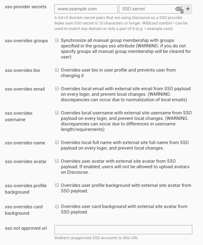

do i need to do something here:
No, you do not need to enable any of the sso overrides settings.

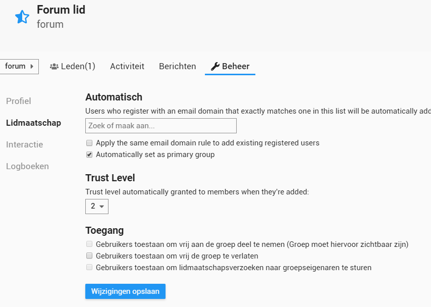

Our user don`t have an primary_group_name, title and some more fields. How we can fix it?
Are these users being added to the group with add_user_to_discourse_group? When added in this way, the users should have the group set as their primary group if you have enabled the ‘Automatically set as primary group’ checkbox on the group’s membership tab on Discourse. If you set the ‘Default title’ field for the group on Discourse, that title should be given to the user when they are added to the group.
1 me gusta
Yes we do that:

we have also enabled the ‘Automatically set as primary group’ checkbox
defatult title is: ★Forum lid★
