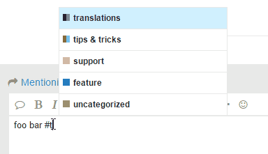

Category mentions do not works if the category or subcategory have letters (the last in my case) with accents.
See:
Plus I have some problems with css but I open another thread for this.
I have some problems with tag mentions too. The autocomplete is very slow in some case and it do not appears after I type the underscore and the first letter of the second word.
See:
This is going to be tricky… Unlike usernames, category names and slugs have no restriction on what letters are being used. Right now the dialect only allows \w which only covers a-zA-z0-9_. I did work on a similar issue once and I ended up having to import a bunch of letter character classes.
Hmm no repro for this. I do see in your gif that the autocomplete doesn’t appear for feat. Do you have a site I can access to try it for myself?
