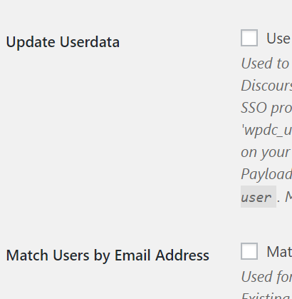

Once I import all Discourse users into WP and enable SSO with WP as the provider. I’ll want to check both of these boxes, correct?
This will sync a user with the same email address and create users in Discourse that don’t already have a discourse account w/ that email address?
No, you do not need to enable either of those webhook settings. The SSO Provider code will take care of that for you.
You may want to enable the ‘Create or Sync Discourse Users on Login’ option that is found on the SSO Provider tab. When that setting is enabled, Discourse users will be automatically created when a user first logs into WordPress. Enabling this setting isn’t required to deal with the users you are importing into WordPress from Discourse.
