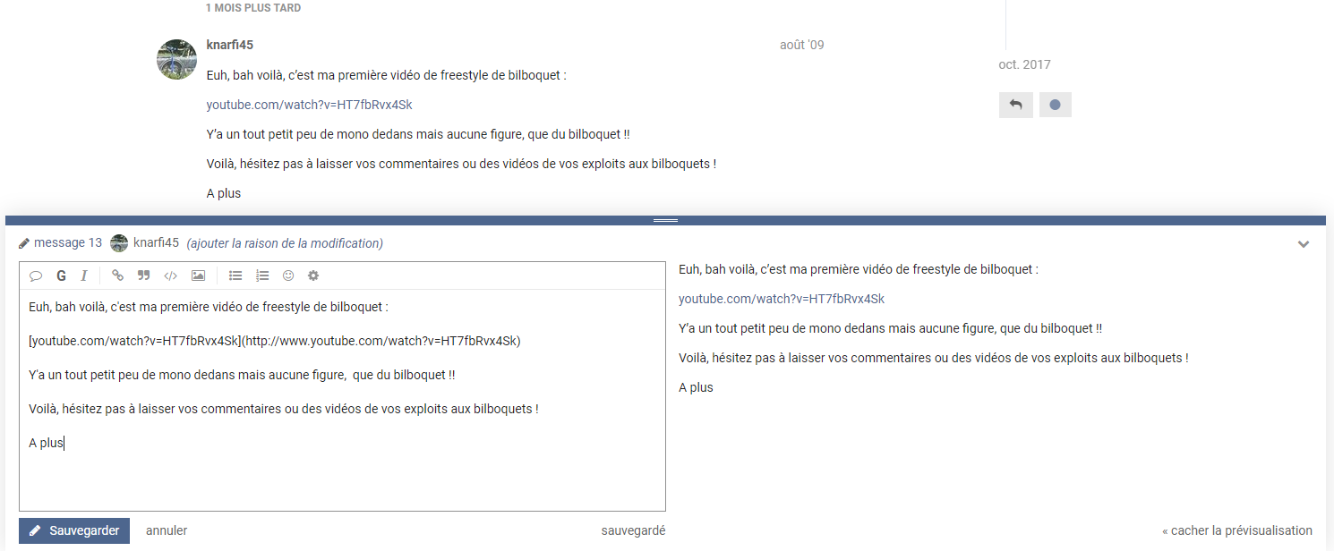

Hi, quick question.
After I’ve imported my phpbb topics, the messages containing a youtube link don’t embed the video.
It appears that they uses the following syntax:
[youtube.com/watch?v=HT7fbRvx4Sk](http://www.youtube.com/watch?v=HT7fbRvx4Sk)
How can I batch convert all these links to embed videos? The links which are not on a single line shouldn’t be embedded also, obviously.
