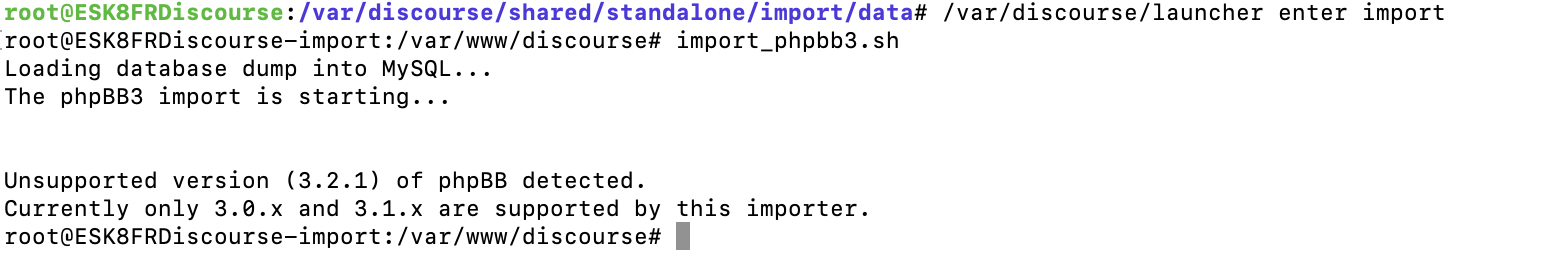

I then run the import script
I’m trying to do whatever I can but I’m stuck. At this time, the discourse was no more working and I had to come back to the snapshot

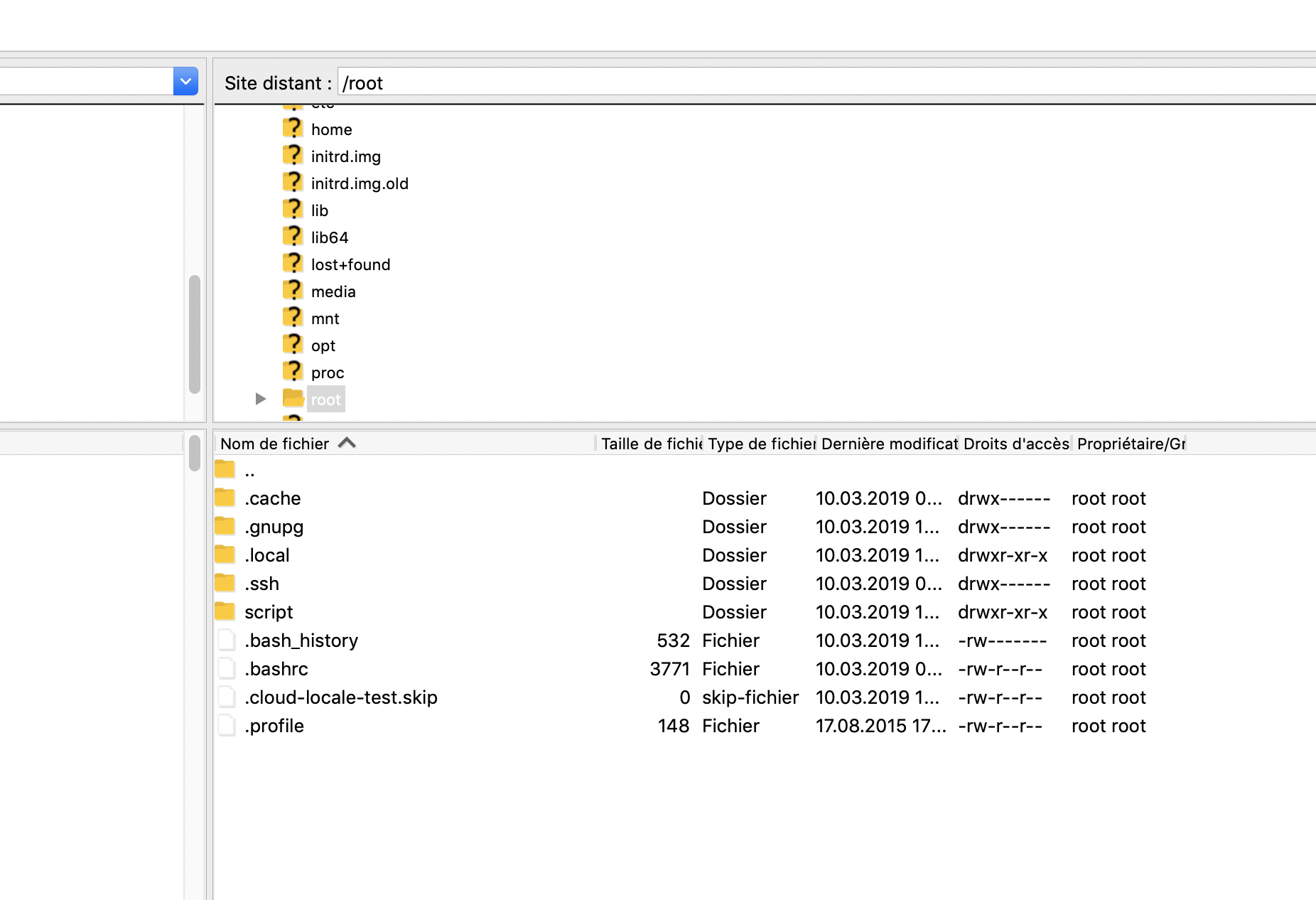

I’ve copied the script folder in my home folder
when I run
root@ESK8FRDiscourse : ~/script/import_scripts # ruby phpbb3.rb phpbb3/settings.yml
It says that that ruby is not found, so I installed it using
root@ESK8FRDiscourse : ~/script/import_scripts # apt install ruby
install goes fine.

Hey Jay, 80 000 total posts. I read the full thread around 100 times for around 2 days now eheh. I just don’t get it. All my previous posts are a complete end to end follow up of the OP. The OP gives a non compatibility with phpbb 3.2.x as a result
You are not following the docker instructions. Your files are not where the OP describes and you didn’t do this:
It looks the 3.2 changes have not been merged. I think there’s a link in this topic, but if you can’t follow the instructions the OP then integrating the other code will be even more mystifying.
With the 3.2 complexity it’s not a job I would touch for under $1000 (but that’s not a promise). My advice is to see if your community is interested in crowd funding the migration.
