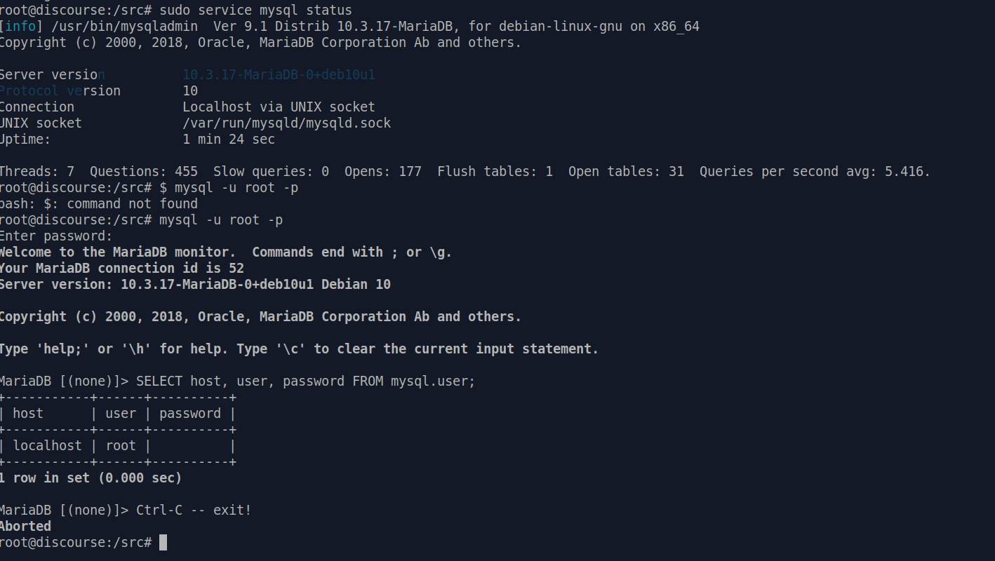

Hi,
First off thank you for this fantastic guide. I appreciate the work that’s been put into this.
For my issue
I’m having trouble with connecting to the database when I run the import script, albeit I’m using Mariadb to house the vbulletin dump rather than mysql. I’ve verified that MariaDB is running, I’m able to import my vbulletin dump into it, and I’ve quadruple checked the username, hostname, and password in the script but still no luck.
I feel as though I’m missing something simple, if someone could point me in the right direction that’d be very helpful
I’m using the following versions
mysql2 0.5.2
mariadb-server-10.3
dicourse master git commit cb8fa46
Full description below

For permissions
root@discourse:/src# mysql
Welcome to the MariaDB monitor.  Commands end with ; or \g.
Your MariaDB connection id is 59
Server version: 10.3.17-MariaDB-0+deb10u1 Debian 10
Copyright (c) 2000, 2018, Oracle, MariaDB Corporation Ab and others.
Type 'help;' or '\h' for help. Type '\c' to clear the current input statement.
MariaDB [(none)]> show grants;
| Grants for root@localhost                                                                      |
| GRANT ALL PRIVILEGES ON *.* TO 'root'@'localhost' IDENTIFIED VIA unix_socket WITH GRANT OPTION |
| GRANT PROXY ON ''@'%' TO 'root'@'localhost' WITH GRANT OPTION                                  |
2 rows in set (0.000 sec)
I have double checked the username and password many times, and even manually set it myself.

It looks like you are trying not to use a password? I recommend using a password. The script assumes that there is a password.

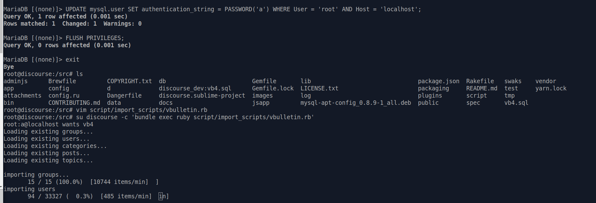

Got it. I’ll try setting a password and seeing if that works. From what I gather though the import script should still work with MariaDB. If so I’ll keep troubleshooting. Thank you for the quick help!
@pfaffman That was it! Thank you so much. Once I get my forum in order I can send a pr for a VB3 version I had in case it’ll be useful to anyone.

Thank you all for the help, the migration went mostly well. There were a couple missing attachments here and there but overall this went great.
For those reading in the future I migrated from Vb3.8.7
I needed to make some edits to the sql query in vbulletin.rb, as my database structure didn’t exactly match the script but it was pretty close. I decided to give up the custom captions to get things moving.
Github diff: File fix other by canyon289 · Pull Request #1 · canyon289/discourse · GitHub
