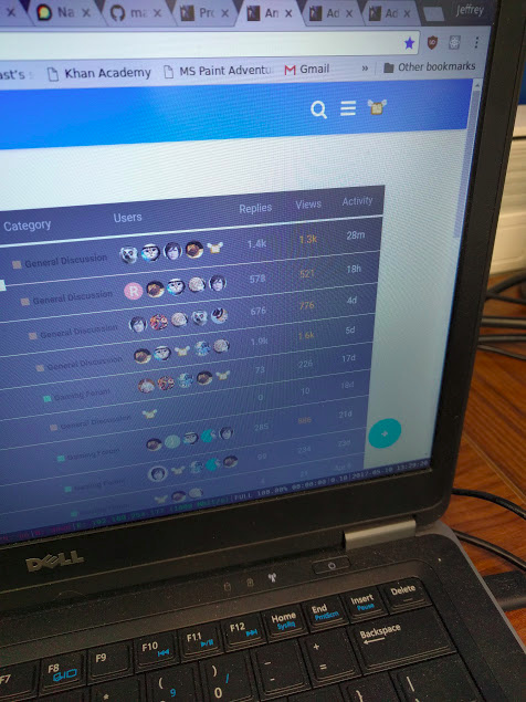

Edit: Not sure if this is a bug here, or in the materials design theme, but it does not seem to update for some components - various elements that use lighten() functions are not pulling from the newly specified color schemes for some reason? Here’s a screenshot when swapping the material design theme from the Material Dark color theme to the Blue/Red theme. The topic body doesn’t look like it’s updating its colors correctly –
(sorry for the cruddy screenshot; ubuntu wants to not play nicely with screenshot tools right now)
specifically this element:
is being computed as:
.category-list, .topic-list:not(.categories) {
    background-color: #3b3b3b;
(Where secondary is fafafa for the chosen color theme.)
If it helps, this is not the default theme, but a user selectable one. The default theme’s secondary is 202020
Can you touch CSS is the theme (which should fix it) and then see if you can break it again?
Be sure to check out latest in “Theme Land” cause you can now ship custom fonts if you need to… :construction:
I can confirm that touching the CSS fixes this, but changing the color theme breaks it again back to #3b3b3b
(Running v1.8.0.beta11 +140 in case I didn’t grab the latest patch somehow.)
You are going to need to be on +147 I think. Try getting latest.

Must have tried to rebuild+pull too soon – looks like this in good, working order post updates - thanks Sam!
