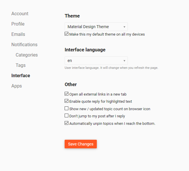

Since the whole point of this feature is user choice, it seems nonsensical to deny that. We really need the
:ballot_box_with_check: Make this my default theme on all my devices
checkbox on that preferences page. It can of course be default on.

Completed per
https://github.com/discourse/discourse/commit/e1dd543a936d8880c6168ae29dbc3d0ad7fa6491
https://github.com/discourse/discourse/commit/f114d63de4b2ed9612347c7d5bcfff61decb0b9e
Checkbox is selected by default, but people can override local.
The tricky bit was that the cookie now stores a “sequence number” so you can override globally.
So, for example:
  • Browser A - pick “material” don’t set it globally - so theme_key cookie now has “theme_key, theme_seq”
  • Browser B - pick “default” set it globally
  • Browser A - Using the power of :hatching_chick: now has the “default” theme set even though it has a cookie setting the theme key to the wrong theme.
