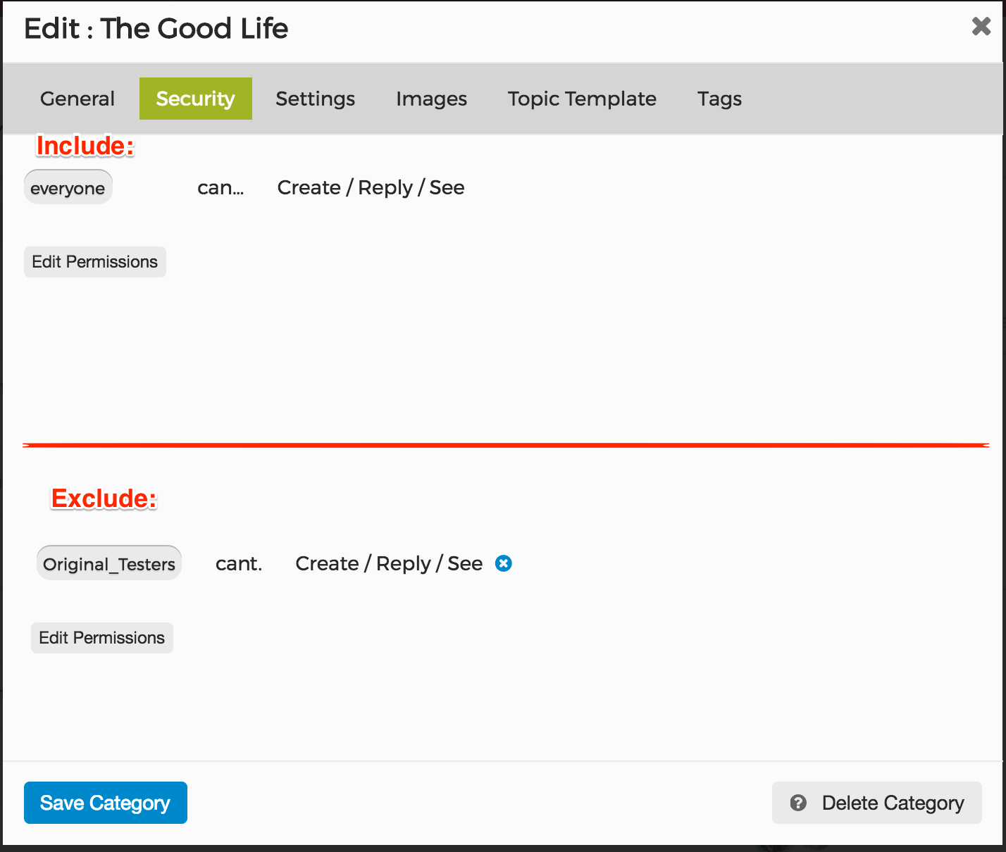

Having Add+Subtract moves the system into a whole range of potential conflicts requiring resolution. At the least, the order of putting in permissions will now be significant, and so there will necessitate a reorder function to move things up/down.
Otherwise, there is no way to resolve potential conflicts when a person:
  • is in more than one group
  • one group is permitted access
  • another group is denied access
EDIT: Or you can say Add always trumps Subtract, or vice versa. Nevertheless, it makes things very hard to understand.
Although I can understand the pain you’re going through in order to request this… I have tons and tons of groups and each category’s permissions list is like 15 long, just to do what you’re looking to do – that is, to exclude a particular group from access while opening to most others.
Indeed, the order will matter
Since all sites are currently like yours, it might be that the solution is to have two steps / sections … the first is the INCLUSION (which is the current context, so even if the change is made nothing is affected) where you build up a total population to view this, then a second step below would be the EXCLUSION which would remove a portion of those that matched certain criteria.
