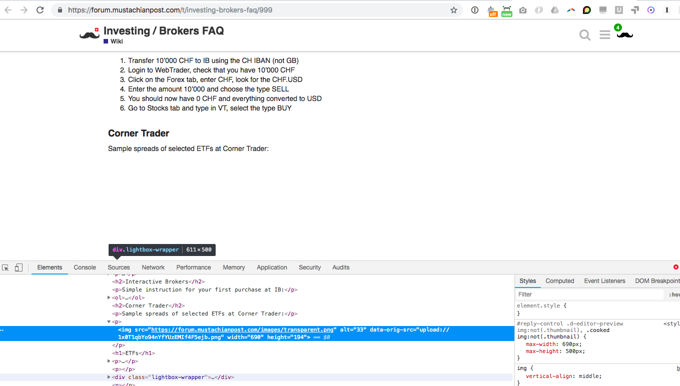

I tried to run your commands to fix broken image on my forum: Investing / Brokers FAQ - Wiki - Mustachian Post Community
Before it was showing a broken link. But not it seems to have replaced it by a “transparent” image.
Any clue why/how to fix the issue definitely?

Then, now, all missing images are still transparent.png, and have a data-orig-src with what seems to be the uploaded file…
Anyhow, I still have 748 images that seems problematic…
Do you have any new tooling to definitely fix this? That would help a lot!

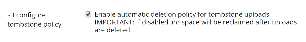

I’ve had a similar issue happen after importing my 2M posts from vBulletin.
Currently running through rake uploads:recover_from_tombstone over 46,000 files.
This is taking a long time – 2.6% in the past 8 hours. Is there something I should do to prevent the tombstone files from being removed while this is running?
Is this setting below applicable or is it just for s3?
Thanks!
