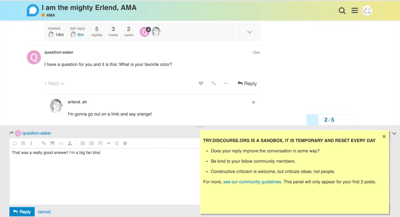

I feel like my aforementioned suggestion just hasn’t been explained well enough. I made a video to properly illustrate what the posting process should look like:
There’s no hackery going on here. I’m merely skipping past the part where Discourse jumps to the bottom of the topic. Instead I transition to the filtered version of the topic with inline replies. The big question is whether this can easily be skipped in code as well.

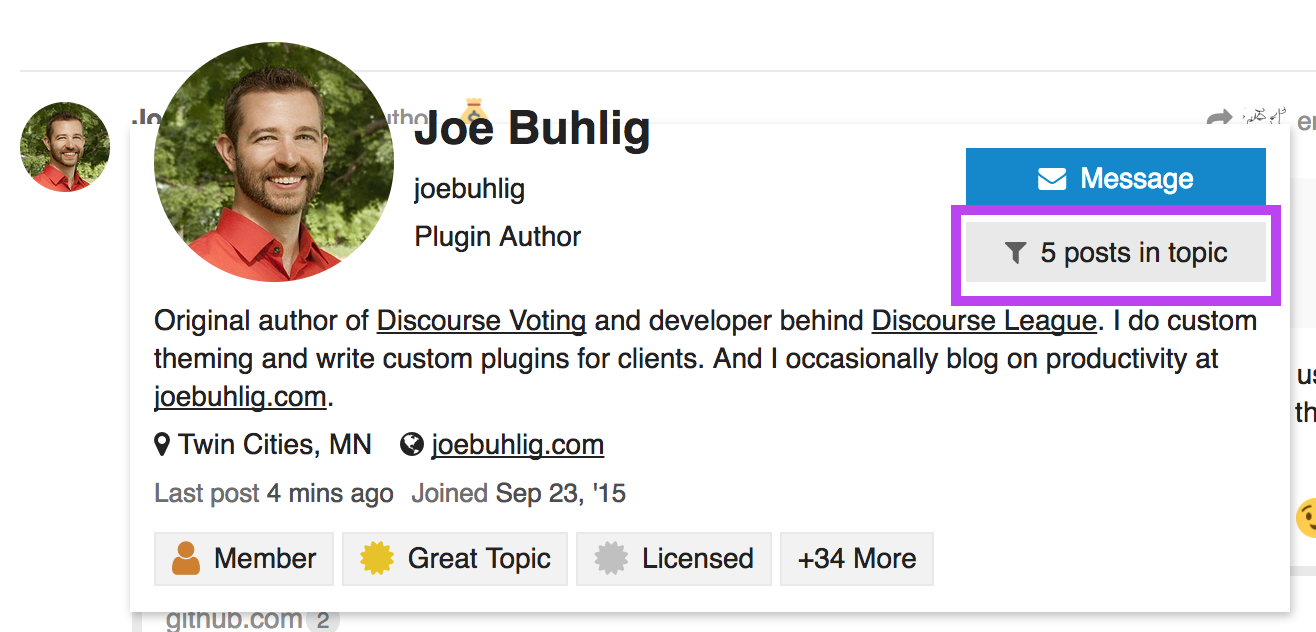

@erlend_sh, it’s been a while, but do you remember how you did this on the front end? I can use the parameter username_filters to hide the post at the bottom but I’m not seeing a way to do that without a server call in any way.

You mean where to find it in the front-end interface? I’m talking about this thing:
I used that to show only posts by the user @question-asker. In the cases of the Q&A format you’d want that filter for every post that is a direct reply to the OP.
I’m essentially trying to find a front end way to hide the post at the bottom when replying to a question so it’s not duplicated on the screen. But when you click on the button you mentioned, it reloads the page to get it done. Is there way to hide a post via javascript? I haven’t been able to find that piece.
