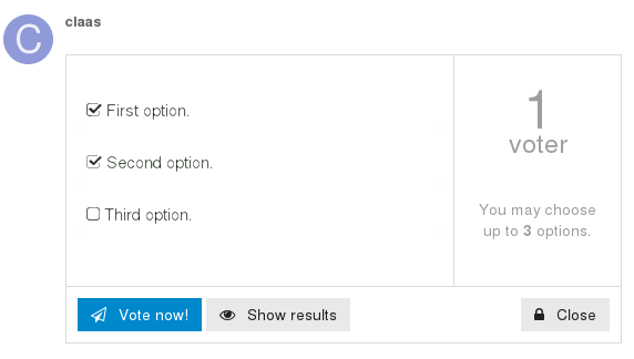

It’s also a regression from
  • button-based UI
to
  • checkbox and radio UI
Really, even worse, it’s a hybrid of both: buttons with checkboxes and radio buttons on them.
I agree with this, perhaps this is the best outcome, @claas you can use CSS rules to style the poll rows as you see fit; if the HTML classes are not there let us know what we can do to add them.

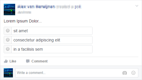

Facebook, single choice:
Facebook, multiple choice:
Polls on Facebook automatically do a postback when a radio button or checkbox is ticket, hence the complete omission of a checkbox.

Do you see the common theme in these examples? It’s :radio_button: and :ballot_box_with_check: !
12 „Gefällt mir“
All of those examples are significantly better than the proposed mockup, the huge issue I have with that mockup is that it tries to be both “buttons” and “radio boxes”, pleasing both ends up pleasing neither.

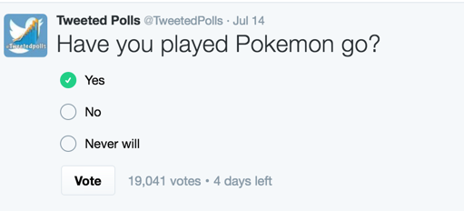

Take a look at Twitter as well
Personally I am fine with a “modernized” list of radio boxes or check boxes. I am against an un-themed form, I think it would look horrible.
I am also totally for changing the markup to use a FORM with INPUTs as opposed to the UL / LI scheme we are using now. It seems much more correct.
I get the complaint here just very much dislike the UX of the proposed changes in the OP.
I think the Twitter styling is fine, modern and definitely something I think we could emulate.
