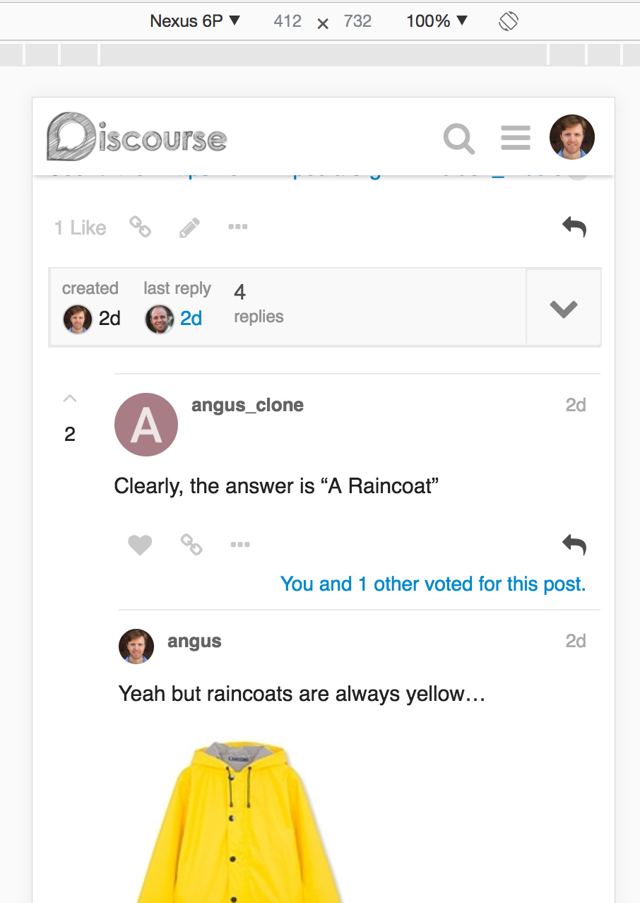

Also, is anyone testing the sandbox out on mobile, page responsiveness is not working.

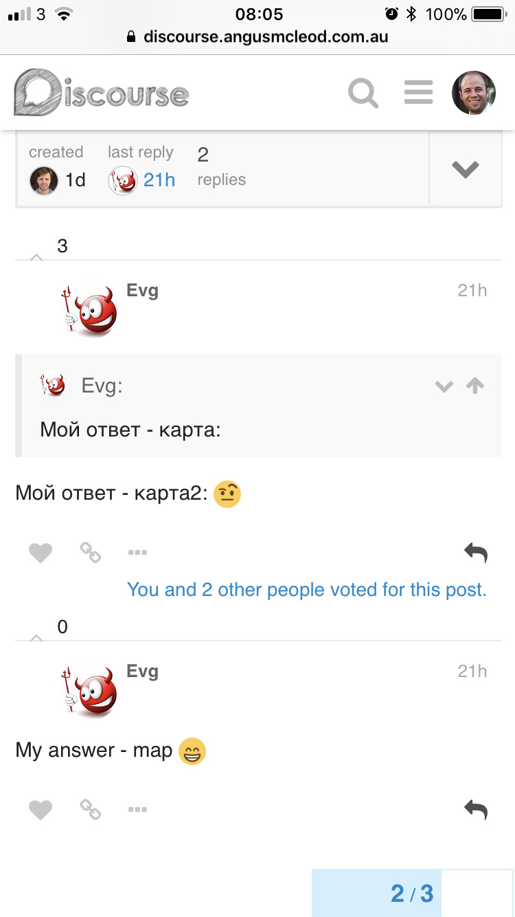

  • The experience is the same on mobile

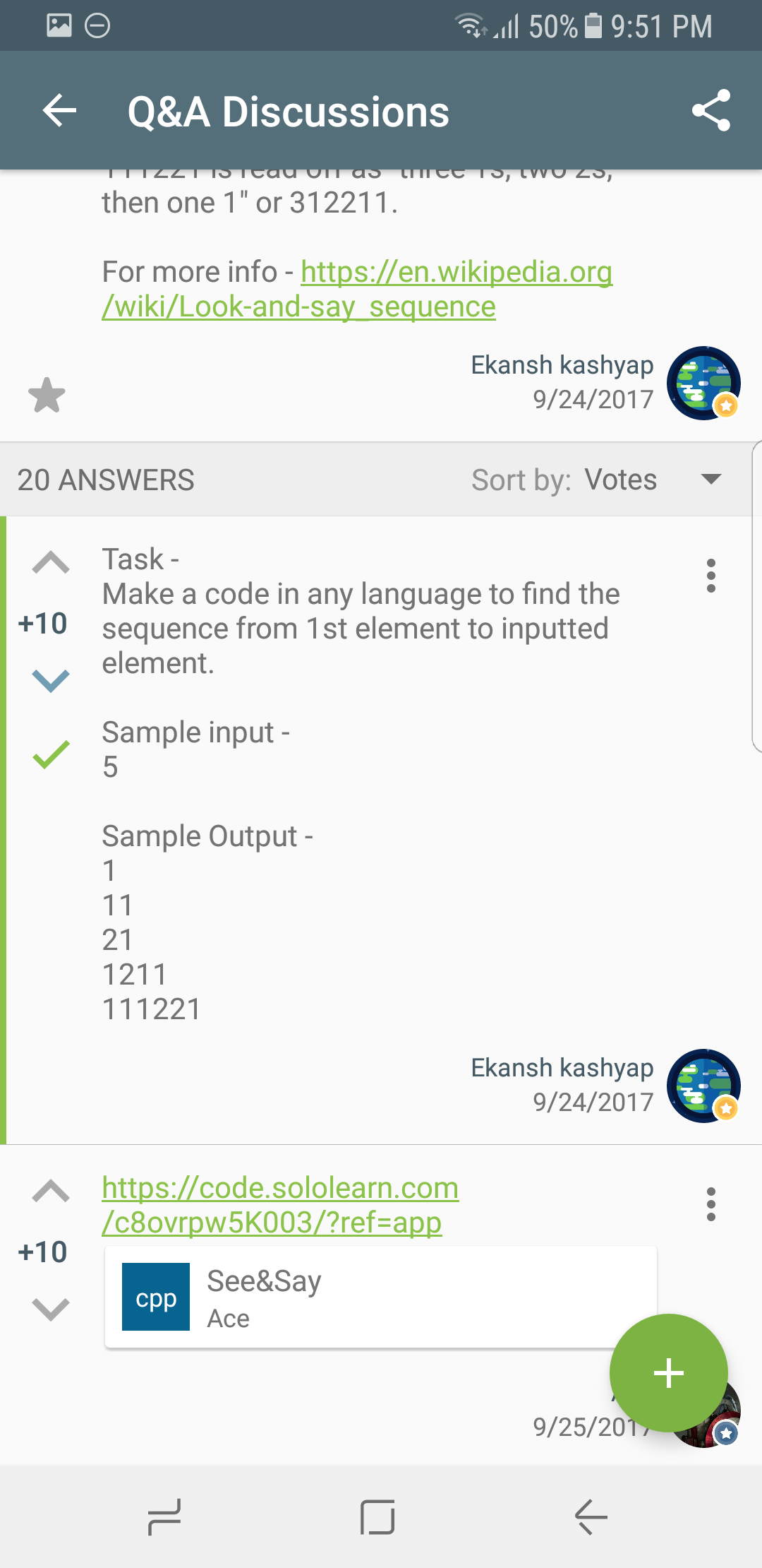

Fantastic work, this really takes things to a new level. The only issue I’m seeing is still the mobile responsiveness issue, here is a screenshot from an s8:

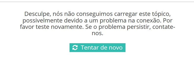

I noticed a bug, at least for me. After installing, all topics could not be accessed, a connection error occurred, after going in the settings of each category and activate the QnA returned to function normally. But if you do not activate, the error happens.
Now I noticed another, the welcome message from the discobot, is giving error, when creating a new user, and the notification arrives, the user clicks and receives the error of the image, of “we can not load the topic”, how can I solve ?
Strange. I’m not seeing that. That looks like an older version. Try again?

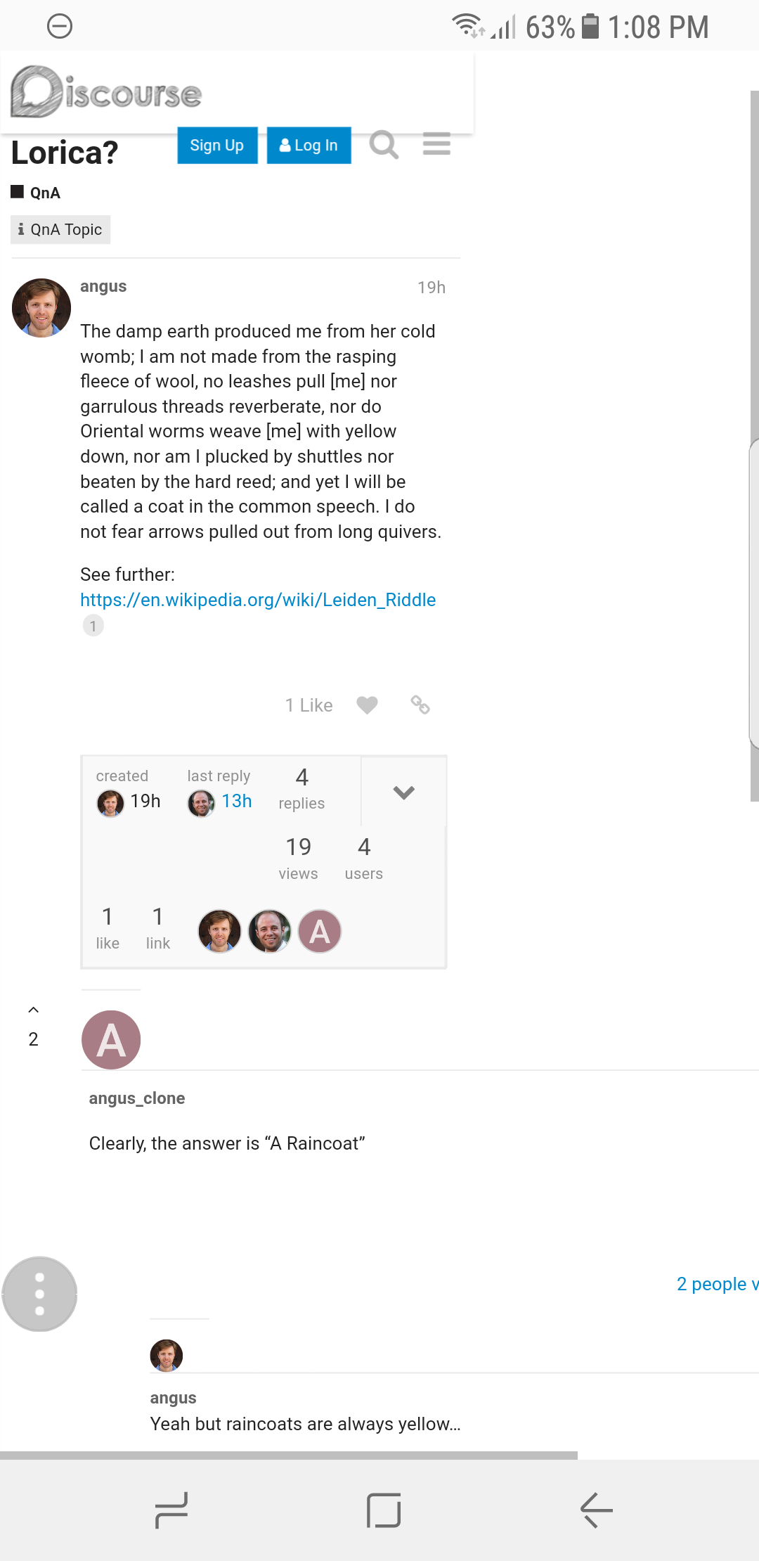

It seems like the error I reported earlier is only occurring in Samsung internet browser (basically a modified chromium build for Samsung galaxy phones), but your sandbox works very well when viewing in either stock Chrome or Firefox.

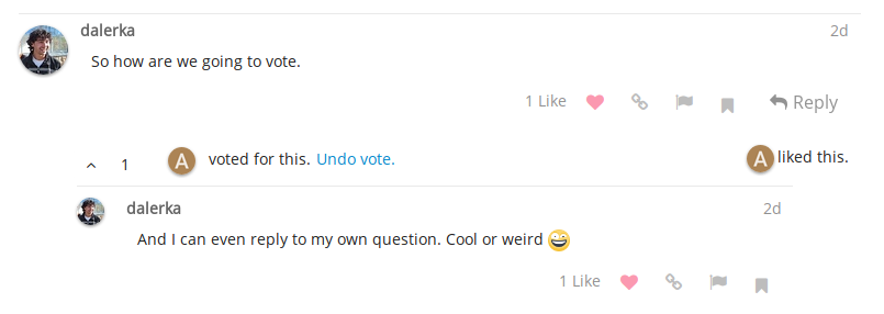

Just a pic to illustrate current state of the art :slight_smile:
