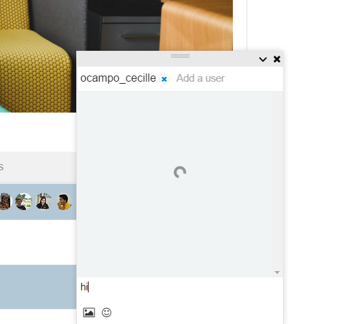

I could no longer send quick message;
It keeps loading.
when you send it , no message appear. all the users are having the same problems.

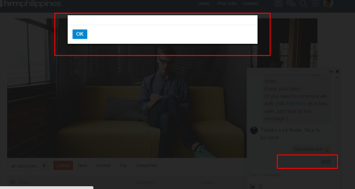

When sending message, I get this pop
@Rodelio_Lagahit @meglio Thanks for the bug reports guys. Trying to pin them down…

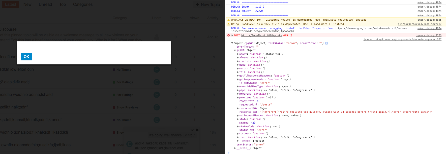

I think this is because of rate limiting. I can reproduce this error by posting quickly. I thought this would come up eventually :slight_smile:
One wat to ‘fix’ this immediately is by changing the create post rate limit.
However, this is not a permanent solution, as the limit is in there to prevent spam. I’ll try to remove the limit from quick messages only.
Removing the limit for quick messages is exposure to spam risk - please don’t do it. That’s why that setting is there. I’d recommend showing the same alert that would be shown to someone if they posted PM messages one after another too often.
The idea here is that if I configure the limit, no way I expect every plugin to respect it.
If you don’t like showing a warning, then create another setting with some reasonable default value. But don’t ignore the rate limit.
Yes, I’m not going to remove it entirely. I think I might try to create a new limit, set it at 1 or 2 seconds by default and let the user configure it in the settings.

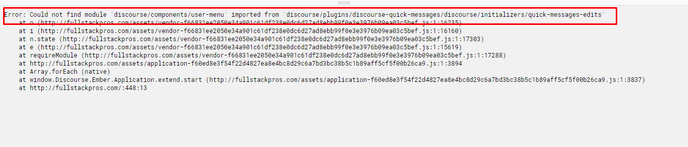

This is what I’m getting in my error logs:
My nav bard looks pretty much empty;
Any reason for this? Or suggested fix? Already removed/install it again and rebuild but I still can’t see the menu.
Check the post immediately above yours.
