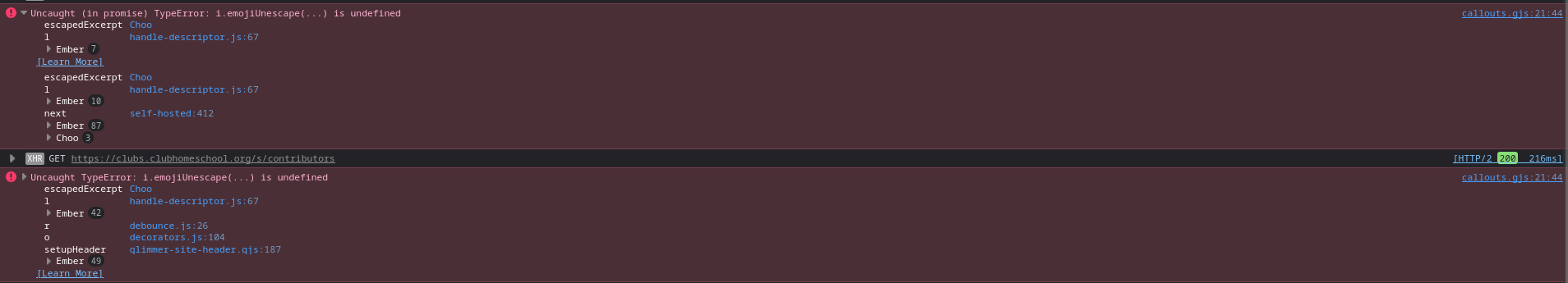

Thanks again for the quick response. This did not fix the error I get a similar error that looks like the following:
I was able to narrow it down to an interaction between your component and the official Discourse Topic Cards component (GitHub - discourse/discourse-topic-cards: This changed the topic list into cards with a modified layout, and a thumbnail if available. · GitHub), you are likely unable to reproduce the error because you do not have this component installed. If you install it and navigate around to different categories you’ll see the error relatively quickly.
Thanks for the details! @dubwoc
I can see an error (not the same, though, but it might be because it’s a dev instance).
It seems that, for some reason, one of the excerpt returns a boolean instead of a string.
I’ve pushed a fix, hit the update button, and try again.
Yep, that fixed the issue on my end! Thank you for iterating with me!
Awesome, thanks for your patience! ![]()
