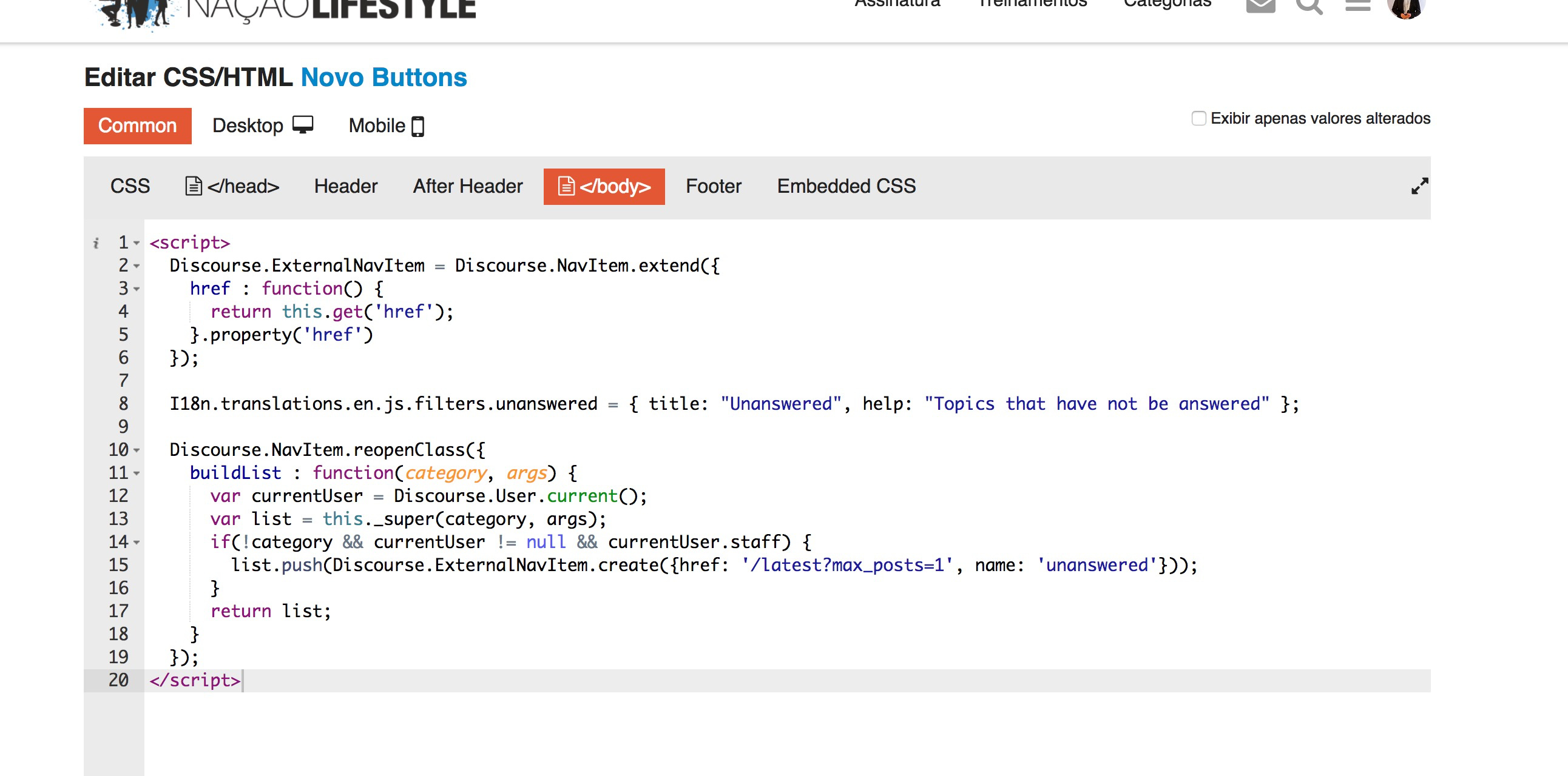

I’ve tried adding but the link didn’t show up. Perhaps 'cause I’ve added some custom links of my own to my header like this:

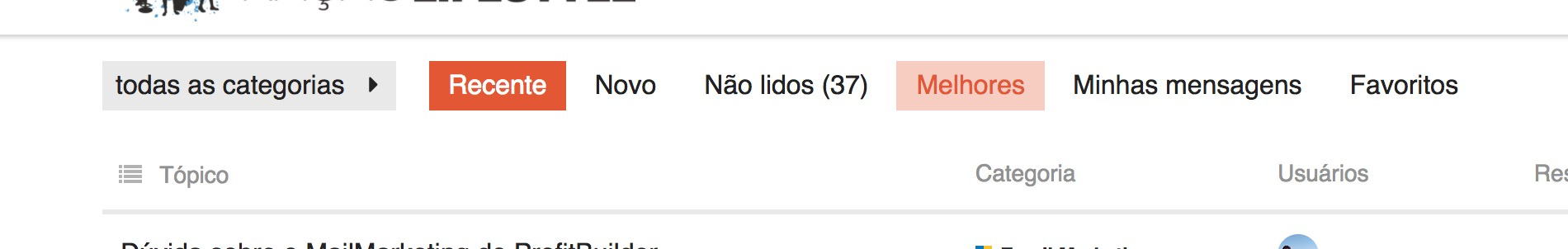

I’d like to show that link here if possible:
Thanks in advance

But I did try to add that code to the section and still does not show at the top menu :confused:
Any ideas of what I might be doing wrong?

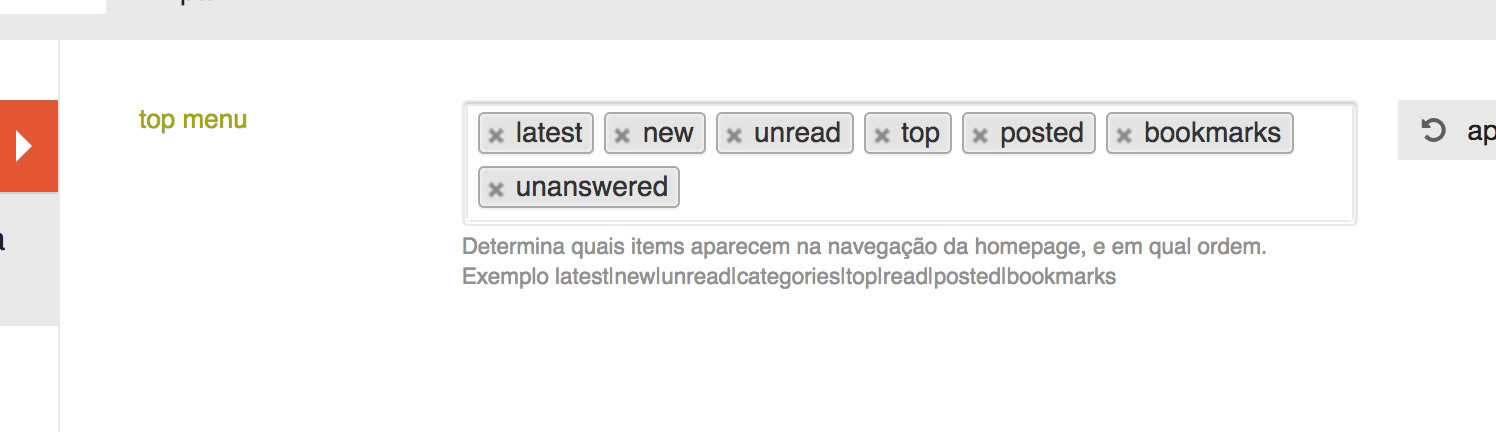

Like this right?
Still nothing here: :frowning:
It is hard to tell if you enabled it from that screenshot. I can tell you I have the exact same snippet on my sandbox and it works fine.

But the placement is correct right?
Edit CSS/HTML > Common > </body>
