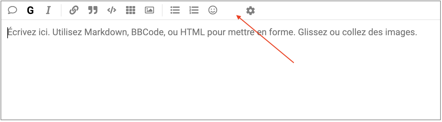

I just have a little issue, the icon to insert a Gif doesn’t appear in the window, do you have any idea where it could come from ?
Core’s icons changed to be based on fontawesome 5 sets, which is probably why the icon’s missing. The plugin would need to be updated here to support it.
I don’t think that is it… it already supports FA 5.
On latest, on my sandbox, the icon works fine…
I need to know the Discourse version and if there are any console related errors on your site.

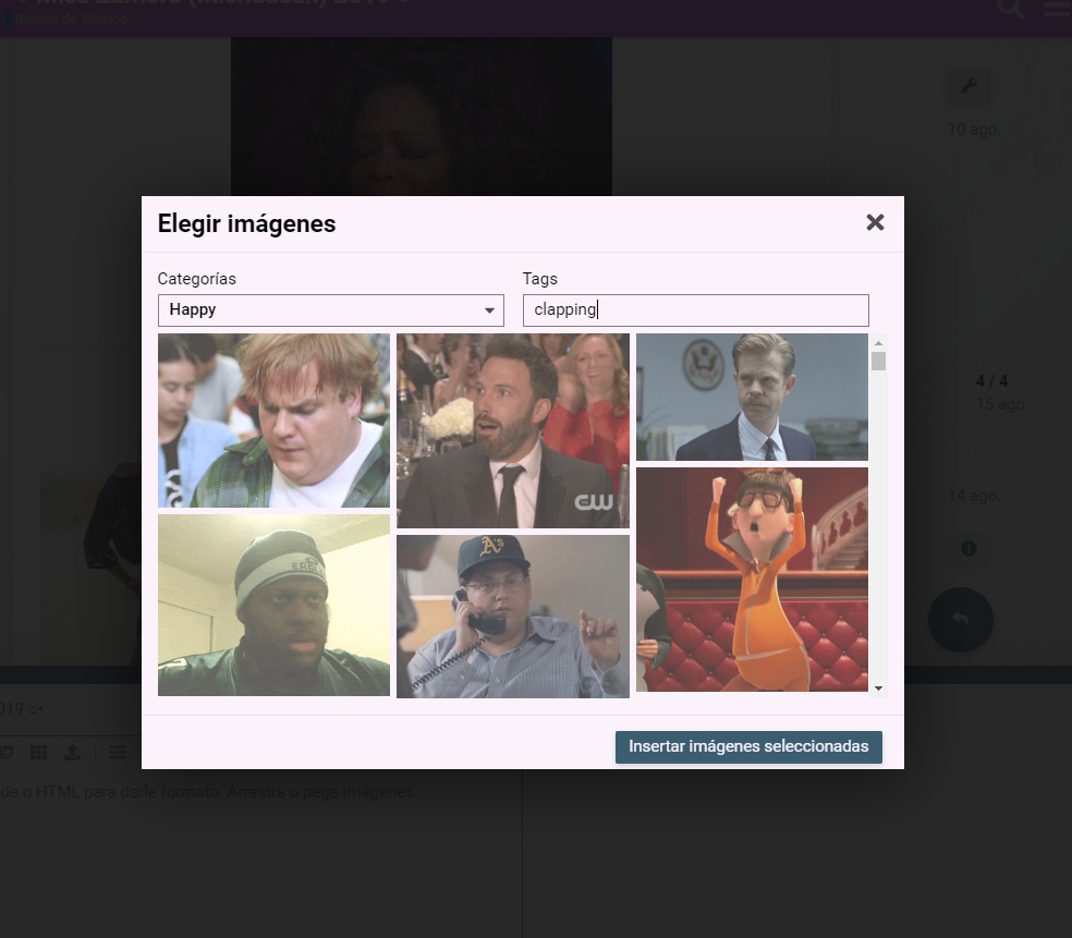

@RGJ Большое спасибо :heart: категории работают отлично, но, похоже, теги не работают.
Похоже, проблема в самом плагине. @cpradio, есть какие-то идеи?
@cpradio Мы в вас верим :heart:
