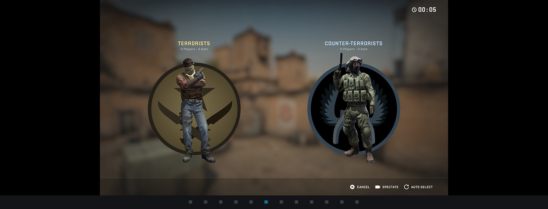

This has to do with the aspect ratio of your images. Slick always maintains the original aspect ratio of the image.
The height of each gallery is determined by the height of the tallest image in it. The width of the gallery is always the full width of the post.
The images you add are slotted in and centred both vertically and horizontally in the gallery. This prevents the page content from moving around when you navigate between images of different heights and keeps the navigation buttons fixed in one place.

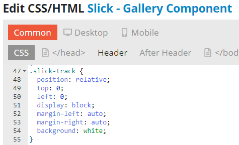

You can control the color of the background with:
.slick-track {
    background: black;
5 إعجابات

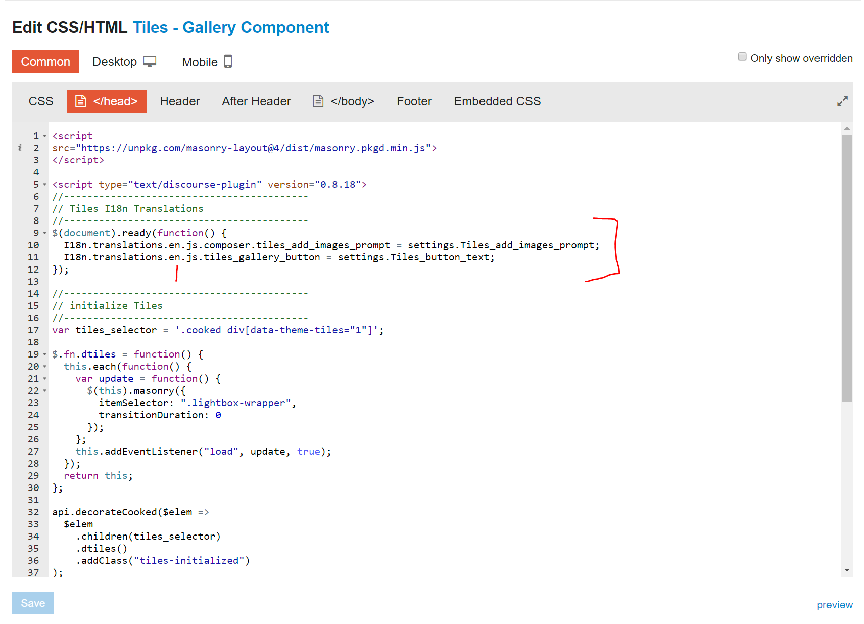

I took a look at the translation issue @Francois_Douville I have a temporary workaround for now. You need to make a small edit to the theme. Go to the </head> section and look for this:
You need to change en to fr
So
  I18n.translations.en.js.composer.tiles_add_images_prompt = settings.Tiles_add_images_prompt;
  I18n.translations.en.js.tiles_gallery_button = settings.Tiles_button_text;
becomes:
  I18n.translations.fr.js.composer.tiles_add_images_prompt = settings.Tiles_add_images_prompt;
  I18n.translations.fr.js.tiles_gallery_button = settings.Tiles_button_text;
That’s all you need to change.
Because this is a local edit, you need to reapply it after every theme update, but it’s not a big problem because you only need to change two letters.

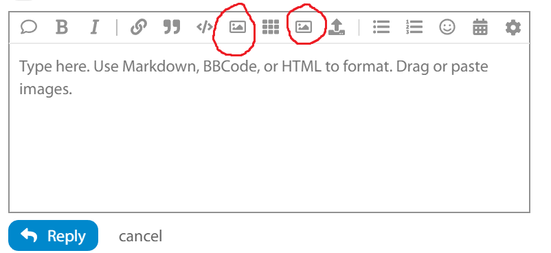

Am I the only one who see two of the same icons for the Slick Image Gallery? It didn’t use to be like that.
When I removed the component from my theme, both icons disappeared. When I added the component back, they both reappeared. Both buttons serve the same function.
إعجابَين (2)

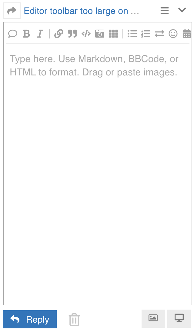

نستخدم كلًا من معرض الصور Slick و Tile (وكلاهما رائع!). لاحظ أحد مستخدمينا مشكلة في النسخة المحمولة حيث تدفع أيقونات Discourse خارج الشاشة (خاصة العجلة المسننة الخاصة بالاستطلاعات وما إلى ذلك):
أعتقد أن هذه قد تكون حالة خاصة تعتمد على ما هو مفعل آخر في تثبيت Discourse يستخدم أيقونات المحرر. في كل الأحوال، لاحظت أن زر رفع الصور في النسخة المحمولة موجود فعليًا في الزاوية اليمنى السفلى، في منطقة بها مساحة فارغة إضافية. هل من المنطقي نقل أيقونات المعرض إلى هناك أيضًا؟ هذا سيحل مشكلة ازدحام الأيقونات في الأعلى، مع جعلها أكثر منطقية (جميع الأيقونات المتعلقة بالصور معًا).

أين/كيف يتم تغيير لون الخلفية؟
لم ينجح هذا:
