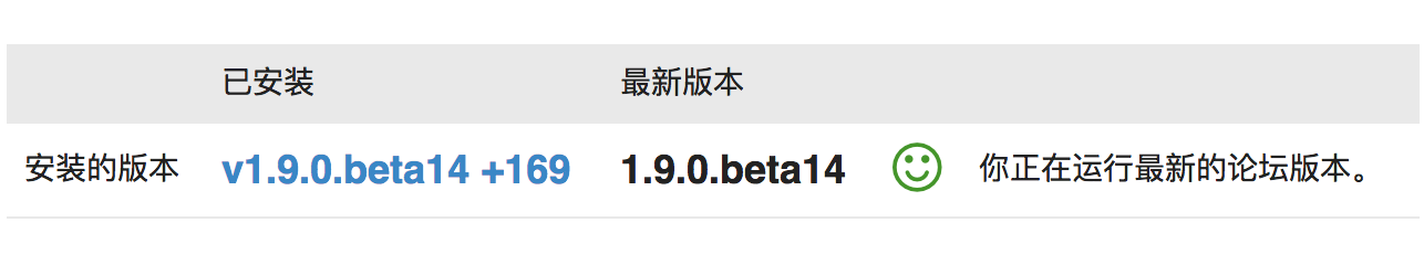

Hi, i installed the plugin, and rebuild done. but there is a error when posts alert 500 Internal Server Error, like this
whilteListIframe is not a function
this is my discourse version.
is this version can’t user this plugins ?
can you help me ? Thanks!

The plugin will not work on your version of Discourse. You will need to remove it from your app.yml file and run ./launcher rebuild app.
You can now whitelist iframe URLs through the Discourse admin/security page.
5 Mi Piace
thank you very mach. it work nice.
